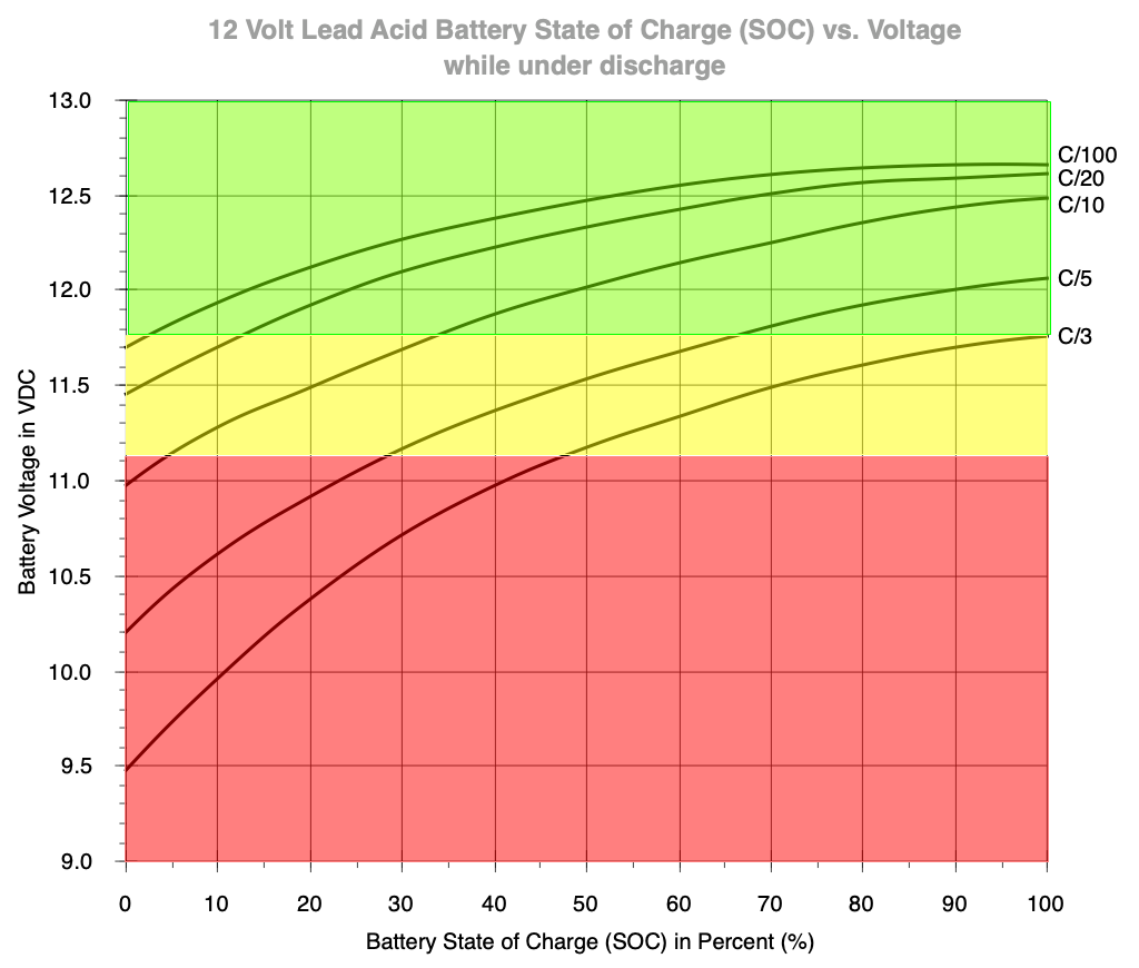

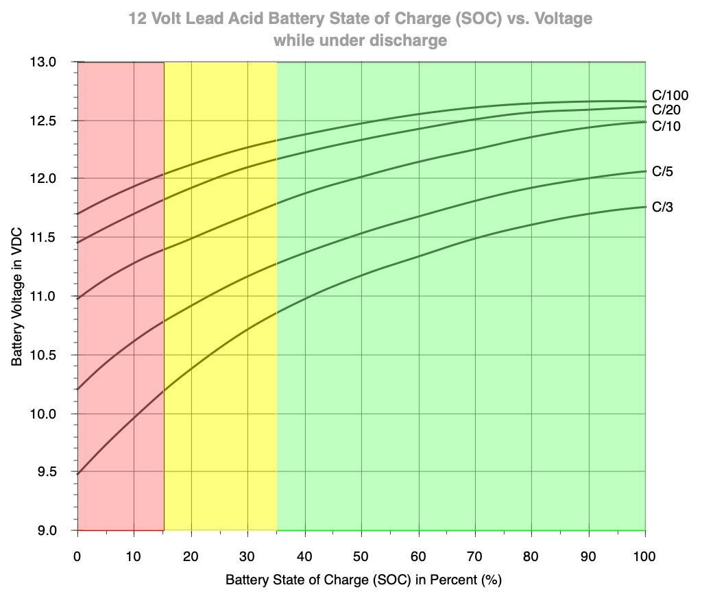

Do not use an automotive battery charger for small SLA batteries, as they are designed for excess voltage. >=14.2 rather than 13.7V
  • Leaving a battery discharged for a long time can lead to sulfation, which can damage the battery (like overnight every day).
  • Use a low voltage cutoff circuit and never go below 30% SoC.
  • Make sure to remove the battery charger after it is fully charged
1749596190832-png.150133
Any questions?
