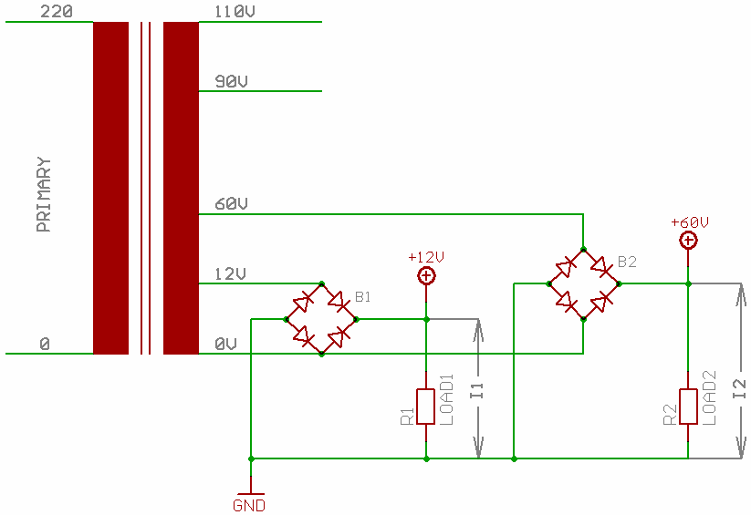

I have a multi tap transformer. Primary is 220V secondry is 0,12,60,90,110 V
The transformer is rated for 20AMPS max which is more that enough for my needs.
I need 12Vdc and 60Vdc from the transformer. Any suggestions as to how I would go about doing that!.
I used one full bridge rectifier for 0-60 to give me one dc conversion and another full bridge for 0-12 to give me the other dc conversion. As I wanted a common ground for both outputs.. I connected the grounds together. Here things went in a different direction. the 0-60V reading was good.. but the 0-12V reading went up to 76V
I used 3300uf 80V caps for filtering on both connections.
It could very well be that I am going about it in completely the wrong way.. any help and guidance is appreciated

I don't know what you did wrong wiring the transformer.
It should work that way (see attachment).
Please make sure I1 + I2 don't exceed the maximum total current of the transformer.

@boncuk Thank you for your input.. This is exactly how I wired the transformer.. R1 Load is 317T regulator giving 6 Volts dc to a 74HC08.. while R2 is a DC motor rated at 60V 11 amps. The total consumption is well below the transformer rating..
The problem is that I am getting 76V reading for 12V supply with no load.. and on load it settles on 32V..???????
For testing I have used 5K 5W resistors as dummy loads on the PSU..
one thing that is not in your schematic is filter Caps .. 3300uf 80V for both supplies..
The 60V supply is good .. no issues there..
Cheers

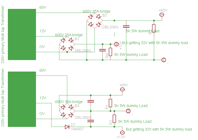

following are the two options that I have tried...
both do not give the desired result.
Help!
Help!

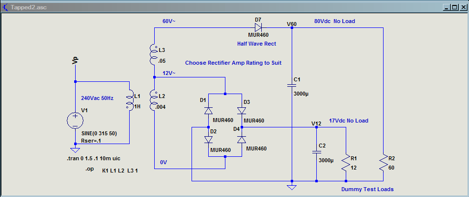

You could do it this way, note the 60Vdc is half wave, should be OK depending upon what you are using it for.??
Cheers Eric,
Will try it out in the next few mins. and let you know if it did the job or not!.
The dc motor is driven by an H Bridge configuration. so I guess Half wave shouldn't cause too much of a problem!

I justy tried the method you suggested.. no joy I am afraid.. now I get 17VDC no load correctly as per your schematic for 12 V but now the 60V has dropped to just around 40 no load..
instead of 3000u Caps I am using 3300 uf 80V..
@eric..
Can you recheck your wiring.?
An LTspice simulation shows that the circuit should work.:)
You say the transformer is rated at 20Amps,, but what is the total VA of the transformer... is it 10A at 110v !!!!

The fact that you show only ~ 40V and the 80V cap blew, suggests that your half wave rectifier is short circuit.
What type of rectifier are you using.??

You cannot use two bridge rectifiers for two separate supplies on an auto-transformer. You would have to have two separated windings.
The A.C. inputs on a bridge rectifier is alternately clamped to ground on each half cycle of the input waveform. The '60v label' will clamp to ground pushing the "12 v label' to 48v and the '0 v label' to 60v.
First get rid of the "O volt" label on the transformer. (unless you ground the transformer at this point, then you can put a half wave single diode at each of the taps).

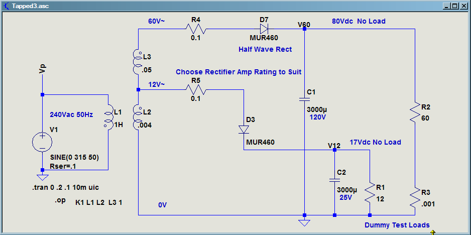

RCinFLA is correct. With a tapped winding that you have, all of the other suggested configurations are wrong. You have confirmed this with explosions and smoke. [edit] My apologies to ericgibbs: Your half-wave solution is the same as I suggest - don't know how I missed it on the first reading. You are correct. [/edit]
You have two choices:
1) Use two totally independent windings. If you use the transformers that you've described, this means you need two of them. With two independent windings, you can use two independent bridges each with their own capacitor and hook them up as you like.
2) Continue to call your 0V terminal "0V". Develop each of the two necessary voltages with a half wave rectifier (single diode) and capacitor. This isn't a good idea at the current levels involved.
In either case, you should use properly rated diodes. 1N4007s are only good for about 1A. You should consider 25A bridges for 10A; if your co-workers or local merchant don't know some, come back and we'll try to help.
