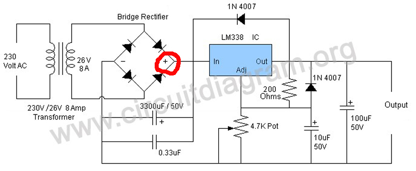

Firstly on this new Multi tap transformer I bought, it says I can get 24 Volts by using two taps, joining the two 12's didn't work, correct config please?
Secondly recommendation for a rectifier to match, specs, good brand etc.?
I need DC for a variable voltage controller device.
Thanks in advance.

It seems I have fallen victim to an "expert", at time of purchase I inquired as to the orientation of the four pins just to make sure, I was shown the + sign on one corner and told that was the AC positive, and the diagonally opposite was the negative, a ten second test was all it took for all the "Special Smoke" to be released, transformer is now dead on all pins, (so much for "Primary thermal fuse fitted"!
Revisiting the schematic it appears that the + is for the DC output side?
Just shows even at 76 you can still learn lessons the hard way.
The normal markings on a bridge rectifier are "~" and "~" for the two AC input pins and "+" and "-" for the DC output pins.
On large square rectifiers it's most likely that the + and - are on opposite corners. The +ve is nearest the chamfered corner. If the terminals are flat tags, the one that points in a different direction to the others its the +ve.
The clue that he was less than an "expert" would have been that AC does not have positive and negative polarity, it only has phase, or hot and neutral.

I'm liking the 30 volts, connected the large rectifier and got fractionally lower DC output, happy days! :)
Next is to decide whether the 18V or 8V is best for the indicator lamp, I think 9 should be enough.
So when I connect it up to the LM338 rig and apply a load (maybe charging a small 12V gel cell?) I believe I should be able to determine the Amps capability by looking for voltage sag? (and heat).
