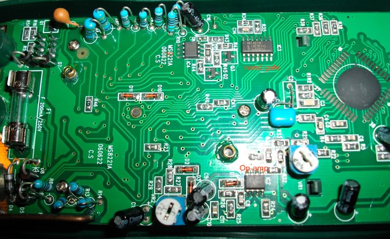

hi
i got another multimeter the same model... and i have exactly the
same problem!!! :rolleyes:
i don't know what i did wrong (if i did something wrong...)
here's a photo of the inside of the multimeter there are few ICs one
is an HEF4011b the other says something 062C/EZ805 (probably it's an TL62 op-amp..) and there is also a COB which i guess it is the LCD controller and the other one i don't know what it is...probably it's a custom made Ic.
can somebody tell me which one can be responsible for the problem?
Thanks!!!

Post a circuit of exactly how you connected the meter and the meter switch setting.
