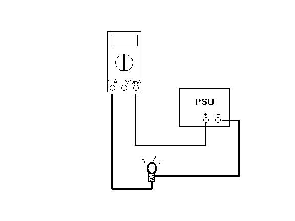

don't you need to have the ground lead of the multimeter connected into the circuit,
it appears you have the 10A and the ma posts connected but the ground on the multumeter needs to be connected than your chouce of the miliamp, or the 10A reange.
I think that's the whole problem.
With that set up you really don't have a circuit.
Ground on the multimeter must always be connected.
lol, I think JCLrd is right, you're using the wrong terminal. GND == COM
Yes the setup you have routes the current through the 10A and the mA circuit in series, which then can blow the fuse in the mA circuit. You need to connect the meter using the 10A and COM terminals, and leave the mA connection open. Didn't the meter come with a manual showing how to hook it up?
