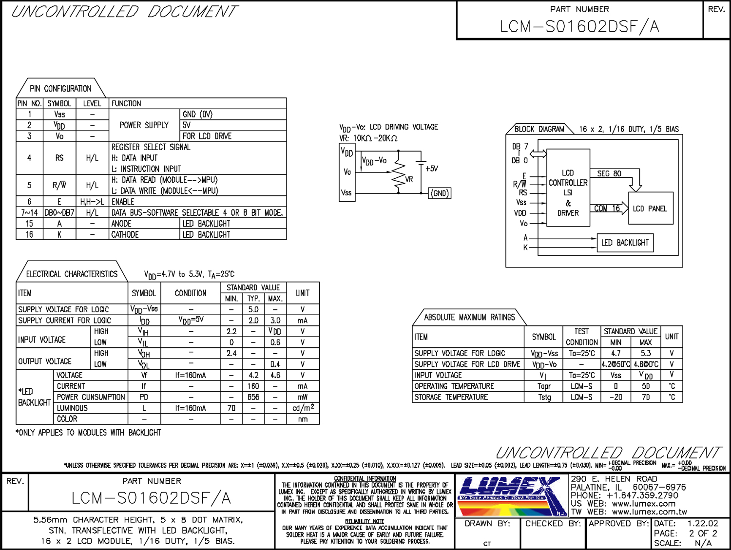

I was going to use it to disconnect the data connections to an lcd character display.
I have added a secondary character display to a handheld unit for a car. I can detach the secondary unit using an IDC connector. The problem is when both displays are ran in parallel they display incorrect characters. If am able to switch off the main display temporarily the secondary should work correctly.
I’m not very knowledgeable when it comes to character displays. I would like to know why it is not possible to just run them in parallel. Are some data bits only making it to one display?
Here is a data sheet for the display that I’m using. LCM-S01602DSF/A. Which pins need to be disconnected to allow the other display to function properly?

Nigel Goodwin said:
I would have thought a pin labelled 'Enable' might give you a hint?.
If it is that easy, Great! I do well with component electronics, but I have never worked with character displays.
I've never tried to parallel two of them, but an enable pin looks a good option to try!. Don't forget pull-up or pull-down resistors on the pins, to stop the unused one floating.
Using a multimeter it looks like low level is used to Enable the display. Any idea what H,H is for? High, High does not make any since to me.
