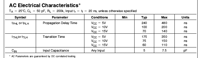

Now, my problem is : something in the circuit is not acting fast enough. If I let my code run at full speed, I get all 8s (with dots) on the display. I have to insert a sgnificant delay between steps 3 and 4 to get a proper display.
I think the 4028 is at fault here.
The PIC's oscillator is 8MHz, so it's running at 2MHz in "instruction cycles".
The 2SC2458 can switch at a rate of 80MHz.
The 4028, at 5V, 25 degrees Celsius has a "Max Propagation Delay Time" of 480ns and "Max Transition Time" of 350ns, which if I read this correctly translates to a total switching rate (off-on-off) of 1.2MHz.
So my theory is that the 4028, when the PIC's pin goes low, is still feeding the transistor for a few ns, which translates into 2 digits being lit at the same time for a few ns.
When I insert a delay time long enough to let the 4028 go low, everything's fine.
What do you think? Am I right or mistaken? Is there something else that could explain my "problem"?

Everything is explained in that single additional cycle. During that cycle, the selected display is updated with the value of the previous display, for that cycle only, before it gets refreshed in the next cycle. If the process is too short, this single cycle glitch may form a siginificant fraction of total refresh time, and this glitch will be more apparent. If you want a strictly glitch-free output, you may latch the display inputs. But this is not used in practise, because latches cost money, and that the human eye is not that sensitive.
I haven't read the datasheet for 4028, but I'm pretty sure that the 4028 can operate at much higher frequencies than the PIC itself.

I understand what you're saying now. I have seen this to be true when step 1 wasn't there. But since I am turning off every segments before going to the next LEDs, shouldn't that resolve that issue?
I have read the datasheet, but can't seem to find anything speed-related, except for the attached information, which just looks like chinese translated to japanese and back to chinese to me ;) I have tried to figure out the 4028's minimum operating frequencies using these numbers, that's where I came up with the 1.2MHz figure in my first post...
Maybe I should have started this thread simply by asking what those numbers mean! :D
