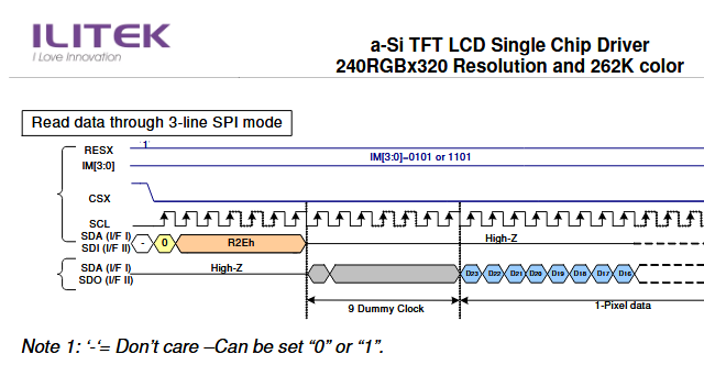

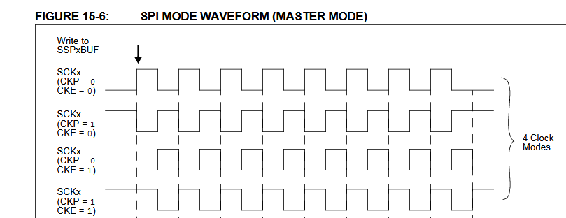

Hi C.. here are two screen shots one on the ILI9341 datasheet and one from the pick
pic
ILI9341 datasheet
It looks to me like mode 2 CKP = 0 and CKE = 1 is what they want on the ILI. The sample is in the middle of data
The st7789 however is sample after clock thats why the ST7789 is better on mode 3..
