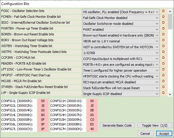

Hi C, here’s a description of the PIC18F16K22 fuses:
' Fuse Configuration:
' Crystal 10 MHz x 4 PLL = 40 MHz, MCLR = On (External Reset)
#define CONFIG1L = 0x00 ' Configuration bits for oscillator and memory settings
#define CONFIG1H = 0x33 ' External oscillator with PLL enabled
#define CONFIG2L = 0x1E ' Brown-out reset and power-up timer enabled
#define CONFIG2H = 0x3C ' Watchdog timer settings
#define CONFIG3L = 0x00 ' Low-voltage programming disabled
#define CONFIG3H = 0xBD ' Port configuration settings
#define CONFIG4L = 0x80 ' Stack overflow/underflow reset enabled
#define CONFIG4H = 0x00 ' Reserved bits
#define CONFIG5L = 0x0F ' Code protection settings
#define CONFIG5H = 0xC0 ' Data EEPROM code protection
#define CONFIG6L = 0x0F ' Write protection settings
#define CONFIG6H = 0xE0 ' Configuration protection bits
#define CONFIG7L = 0x0F ' Boot block protection enabled
#define CONFIG7H = 0x40 ' Configuration settings for block protection
I usually stick to the default configuration, only adjusting the settings related to the oscillator (type and frequency in MHz). I ensure that options capable of generating a reset to the microcontroller are disabled, which is typically the default setting.
During project development, I find this initial configuration to be the most stable. Once the project is complete, I adjust the settings based on the environment where it will be installed. These adjustments are rarely critical because I incorporate various protections into the PCB, such as anti-parasitic suppressors, a high-quality power supply, proper component placement, ground planes, and so on.
If you ask me what CONFIGS 2L, 2H, 3L, and 3H are, I don’t usually take the time to analyze them. I just go into the fuse configuration window and enable or disable the options I’m interested in. Remember, in this window, the fuses are listed by description rather than by numbers. Also, every time you change a value in the fuse configuration window, the corresponding configuration word at the bottom updates and shows its value in hexadecimal format.

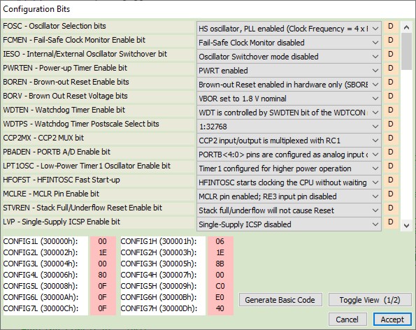

Hi C; I have already left the configuration several times but I leave it again for the PIC18F46K20 with the oscillator using an external crystal.
Hi D,
Yes, thanks, but for some reason I have difficulty with reading this, and the combinations that make up a CONFIG.
e,g, for my PCB with on board programming, I need the MCLR PIN enabled, so if I simply switch to your settings, without reading all of the changes, I can get problems, so I need to know accurately if the changes apply to me.
C.
