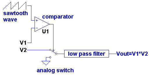

You can make a low frequency analog multiplier with a pulse width modulator (the sawtooth and comparator), an analog switch, and a lowpass filter. Here's a block diagram:
