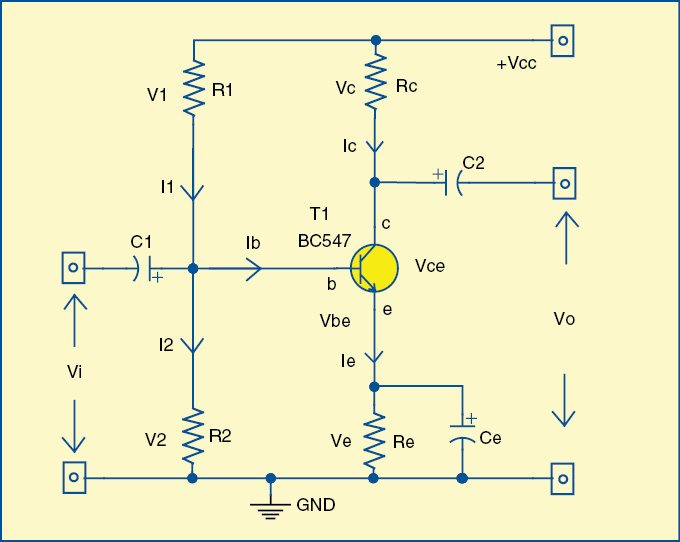

Transistors are current amplifiers; that's the essence of what you need to know. Most other parts come down to Ohm's Law.
eg. This is a basic single transistor amplifier stage, found all over the internet, that can be cascaded for more gain; the output cap becomes the input cap of the next stage.
The way I go about designing with that circuit is firstly decide the standing bias current, probably 10 - 20mA for a general purpose amp stage.
You know the intended supply voltage.
Then calculate Rc to drop somewhere between a third and a half supply voltage at that current.
Set the DC gain (or only gain) by dividing Rc by the required gain, to get Re.
R1 and R2 then form a voltage divider to set the voltage on the base, which in turn sets the voltage on the emitter; that voltage should be calculated to set the original bias current in the emitter resistor.
The transistor base current will be the emitter current divided by its gain. The current in R1 & R2 needs to be either several times that so it does not affect the voltage too much, or you need to reduce the upper resistor slightly to allow for the base current.
You can think of the bias voltage and emitter resistor rather like a typical, simple, constant current circuit -
Except, variations in the vase voltage also vary the emitter voltage (like an emitter follower circuit) and so modulate the emitter and collector current...
The variations in collector current cause a much larger variation across the collector load resistor, giving amplification of the input signal.
Adding Ce (or a capacitor in series with a resistor) across Re mean the AC signal gain will be higher, by the ratio of the overall emitter load impedance at whatever the signal frequency is.
eg. A rough example:
15V supply, 10mA standing current.
Collector voltage around 9V, so 6V across Rc; 600 Ohms. Use 560.
Gain of 10, so emitter 56 Ohm; and 0.6V across that with the same current as the collector.
That means bias around 1.2 - 1.3V as a starting point.
Rough estimate bias chain eg. 200uA to be several times base current; that means somewhere around 75K total.
15 (total volts) / 1.3 (target bias) = ~11.5
75 / 11.5 = 6.5, call it 6.8K
75 - 6.8 = 68.2, so the upper resistor can be 68K and the lower 6.8K
That gives a starting point, adjust as needed to get a sensible collector voltage with roughly equal readings across the collector resistor and transistor.
That would likely do as the second stage of the amp, with a similar one but all resistors eg. 5 * higher values as the first stage?
That should give gain of around 100 and non-inverting (via double inversion) as required.

You have a 7.5K as collector load in the middle stage, then two 10K (so effectively 5K) as bias for the buffer.
In most cases, the input impedance of any stage should be a lot! higher than the output of the one driving it, to avoid attenuation and distortion.
I've tweaked the values and adjusted the gain a bit to get the required response and levels, into the 100 Ohm load as stated.
You need to add an input buffer to get the input impedance above 1 Mohm as in the requirements..

I see that you decreased 7.5K to 1K and adjusted accordingly and also increased buffer input resistance. But why did you decrease the Collector resistance of the second stage. If the input impedance of the stage needs to be lot higher than the output of the one driving it I would expect to use a higher Rc and Re value for the middle stage. For the input buffer I need to use lot higher value resistors for biasing I assume. One final thing: Do I need the emitter bypass capacitor at the fist amplifying stage. I understand that it increases the gain but I wonder if the same effect couldn't be achieved with lower Re value.
The third stage has a 10K bias resistor to positive, plus (I can't remember what) to negative, which can be considered in parallel as far as input impedance goes.
The driver output impedance needs to be a lot lower to minimise attenuation and distortion, which the 1K collector load in the second stage is.
I usually prefer to avoid the emitter bypass cap, but going too low with just an emitter resistor makes the biasing very critical, as the emitter steady state voltage is so low. A higher value Re plus a capacitor-resistor bypass makes it less critical while providing controlled gain.

Two, 50K bias resistor in parallel means 25K impedance at that point, before you even get to the transistor.
That is the "Thevenin equivalent" of the two bias resistors.
As long as the buffer transistor has a gain of over 400, its input impedance should be over one Megohm. The emitter resistor could be made a bit higher, eg. 4k7, to give a better margin.
I've modified the bias circuit to separate the voltage divider from the transistor base, using a separate base resistor. That 1M is adding loading to the input making the input impedance less than 1M overall, so I've also added a bootstrap cap as Nigel suggested, to minimise the loading caused by that resistor.
Thinking further, it should be possible to use a higher value still in the emitter, eg. 10K, and directly connect the base of the next transistor to that, eliminating it's coupling cap and bias resistors, just setting the bias of the buffer to give the same voltage at the buffer emitter as the second stage base has at present.
That would further increase the input impedance of the overall circuit.

The circuit worked as intended, only problem I had was measuring input and output impedances. The input impedance seem to be something infinite. Also 100 ohm resistor at the output buffer caused some distortions but switching it with 220 ohm one fixed the issue at the cost of low output impedance. Anyway assistants were ok with it at the end, thanks for fixing the circuit.
rjenkinsgb
How are you measuring the impedances?.
Adding a resistor between the source and the amplifier than finding the ratio of the new gain and old gain and similarly doing the same for the output.
The 1M resistor plus bootstrap should make it appear extremely! high.
The output distortion may have just needed a slight bias adjustment to optimise the working signal range, or the input was a bit high?
Input I used for testing was 50mV. I wish I tried changing the bias but I think 100Ohm output impedance requirement was a bit to low anyway it was heating up the emitter resistor to much. Actually in LTSpice it is supposed to pull more current (Re) but in real life it does not and causes the weird distortion when Re is 100 instead of 200 which causes the waves to look thicker and compressed.
I see so it doesn't scale like I thought it would.
Well there's little point altering the value of R2, as the whole idea of bootstrapping is to effectively make R2 very high impedance. It also has to be a low enough value to provide sufficient DC current to the base of the transistor.
