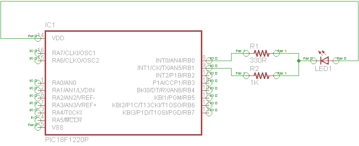

led2-png.19787
Here I am using the PIC to sink current.
Set RB1 as an input and put 0 on RB0 for full bright.
Set RB0 as an input and put 0 on RB1 for dim.

Hi, I don't know why but the led is turned off all the time. Do I have changed LATB to 0b11000000;
setting RB6 and RB7 as input port. I have put 1k and 330 Ohms resistor, it doesnt light up. I changed to smaller resistor, also doesnt light up. What happened actually?
I pulled down to 0 to light it up, but nothing happened. Weird...
Did you set TRISB as needed?
VDD is connected to the annode + side of the LED. When TRISB =11XXXXXX
both RB6 and RB7 are inputs and the led is off. To use the path through RB7 set TRISB=01XXXXXX and LATB=0XXXXXXX. To use the path throubh RB6 use TRISB=10XXXXXX and LATB =X0XXXXXX. Where X is a don't care.

If you are using B6 and B7 as the two outputs to the LED then you need to do,
For the brake lights,
TRISBbits.TRISB7=1;
TRISBbits.TRISB6=0;
LATBbits.LATB6=1;
For normal lights,
TRISBbits.TRISB7=0;
TRISBbits.TRISB6=1;
LATBbits.LATB7=1;
For none,
TRISBbits.TRISB7=1;
TRISBbits.TRISB6=1;
This assumes the lowest value resistor is on B6 and the LED goes to GND.

it is weird, it doesnt work. I used 47 Ohms and 220 Ohms low value resistor, but it doesnt work. I connected as 3v0 drawed yesterday. The positive 5V connected to LED+ and the minus parallel to two resistors ended at RB6 and RB7.
It doesnt light up at all.
As I said, that code assumed the LED went to GND. If it's connected to Vdd then you want 3v0's code.
TRISBbits.TRISB7=1;
TRISBbits.TRISB6=0;
LATBbits.LATB6=0;
For normal lights,
TRISBbits.TRISB6=1;
TRISBbits.TRISB7=0;
LATBbits.LATB7=0;
For none,
TRISBbits.TRISB7=1;
TRISBbits.TRISB6=1;
thanks it is working, now I will try to make the States. State1 = forward, State2 = Braking, and State3 = Reverse/backward.
Thanks Pommie.
The problem you had with the LEDs shows that you do not understand sinking and sourceing.
If the PIC provides current you are sourcing the LED current. The annode + side of the LED goes to the PIC pin and the cathode - goes to ground.
If the PIC recieves current you are sinking the LED current. The annode + side of the LED goes to the + (VCC) and the cathode - goes to the PIC pin.
