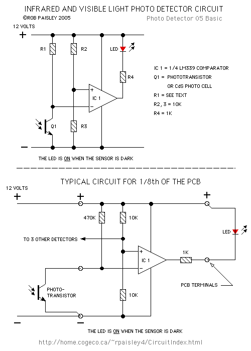

both my teacher and the guest engineer told me to use this circuit (the one attached) but to replace the phototransistor with a PIR reciever/sensor i think and the LED will stay the same as the output
this is only for now though, but we'll keep adapting this in the coming weeks (after my good old mocks before and after christmas!)
thanks for the help so far though! i'll keep posting if i need anymore help. feel free to comment on the attached circuit though

Hi Mademoiselle (or girlie),
The comparator oscillates if the input reaches the threshold slowly.
The datasheet and everybody recommend adding a little positive feedback to create a small hysteresis. Then its output will switch quickly and not have time to oscillate.
