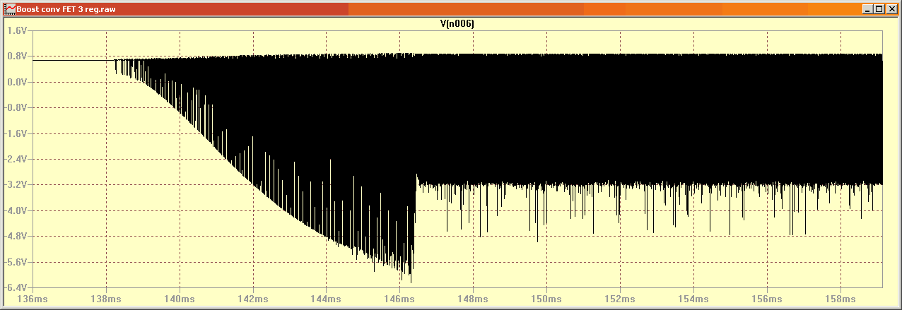

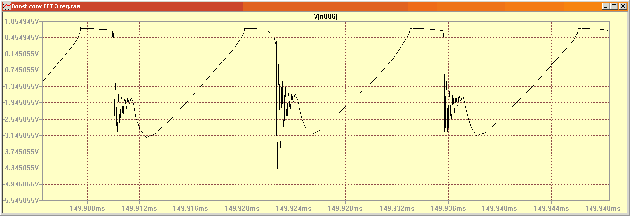

Without it there are large negative-going pulses to Q1's base which I thought might be harmful to it. It does reduce efficiency somewhat. The LTspice trace of Q1's base voltage is attached below; the maximum negative pulse is more than -6V, with the average seeming to be somewhere around -3.2V. (The 2nd picture shows a closeup of the pulses, including ringing on the trailing edge.) Should I worry about this or not?

The battery voltage is too low to cause problems, it's a standard technique when you use higher voltages to prevent reverse Vbe breakdown, but it's not required at this voltage.

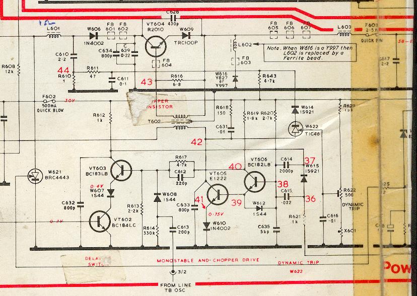

By the way, if you wanted to add regulation, the worlds first domestic use of a switchmode PSU (the Thorn 3000 colour TV) used a monostable - it had two timing capacitors on one half, connected by a diode - the regulation worked by switching the diode ON or OFF and so altering the pulse width by paralleling the two capacitors.

I have no doubt that this is true. I went ahead and removed the diode and re-ran the simulation. Turns out that it actually increases the efficiency significantly (from 61% to 73%, at an output of 180mA), probably by removing the ringing and cleaning up the waveform. So I guess it should stay.

I'll see if I can find the circuit at work and scan it, I couldn't find it on google - but it LONG predates the Internet and home computers so that's no surprise.
Bear in mind, I haven't seen the circuit for probably 30 years!, but I can still remember it reasonably.
I think if you connected R2 to the output capacitor, with a parallel bleeding resistor to get things started, you might actually get PWM regulation. There is some math that would be involved, but I'm too lazy to do it.
When regulating, the FET on-duty can be quite small by percentage and C1 can charge to the full boost voltage (the highest voltage that appears at the inductor) then when FET turns on C1 causes the Q1 base voltage to go below ground by that voltage.
That will mean around -9v Vbe each cycle which may be too high for safe operation, which is why I included the Vbe diode in the original circuit.

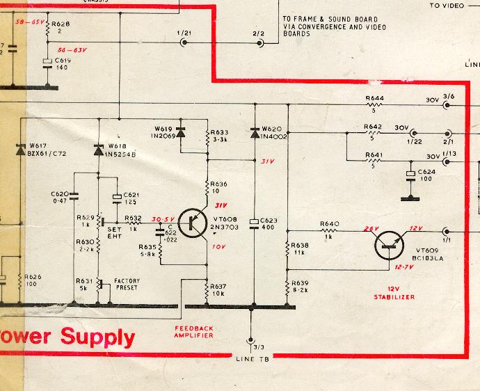

OK, I've dug the manual out of the attic at work :D
Here's a couple of scans showing the monostable and feedback system.
The two capacitors are C614 and C615, with W615 switching them together under the control of VT608.
I built a jig for repairing the panels from these sets, I can't imagine how many PSU's I repaired over the years.
I hope this gives you some extra ideas? - late 60's, early 70's technology, the worlds first domestic SMPSU.

Hey, Nigel--thanks for digging out that old service manual! Very interesting. Nicely documented.
So this seems to be where the action takes place:
C614, C615 and W615. (Never before seen diodes marked "W".) Not exactly sure how this all works, though.
When the regulator transistor turns on, it forward-biases the diode, correct? Which--what?--then adds the smaller capacitor (C614, 2000pF) in parallel with the 0.022uF? I'm never sure about polarities and such in circuits like these.

Have a read of the text I scanned, which explains how it works - it's an interesting old idea, and could make a simple multivibrator design easily regulated. The original TV's worked really well.
