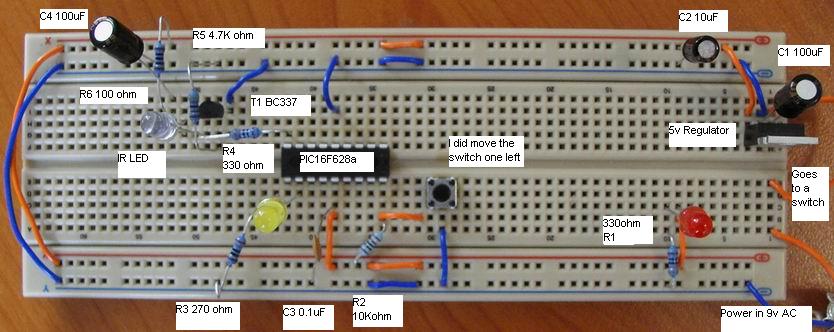

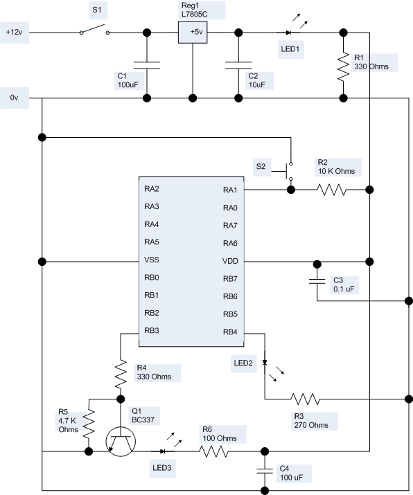

OK I have taken photos of the breadboard and had a go at drawing the circuit diagram. They are attached.
Most of the code and circuit diagrams are from Nigels Tutorial Site or Mike Predo's (spelling?) with my twist which is probably the reason for it not working.
I also tried the test elbc suggested however when the multimeter probes go anywhere near the pin in question it goes low, so my finger is not the only magic thing in the world.

Try removing LED1 and R1, the Vdd pin of the microcontroller should be connected to the output of the voltag regulator.
In your schematic LED3 is backwards.
Yep the output of the regulator goes to the PICs VDD. Here's a typical hookup (it's missing the filter caps yours correctly has but does have the 0.1uf decoupling caps)
on your picture, you have the incoming power "POWER IN 9V AC" but on your diagram you label the power as "+12v" (ac or dc not specified)
feeding 9v ac into the regulator is going to make it rather hot, and should have blown out that big capacitor you have on the input
in the diagram, you show the LED being in series with the regulator, and a 330 ohm resistor connecting the positive rail to ground. On the breadboard, it appears the led and resistor are connected correctly, in parallel with the regulator.
On the PIC, Pin 4, RA5 / MCLR should be connected to the positive rail with a 10k resistor.
On the left side of the breadboard, there appears to be four wires leaving the circuit - where do these go? If I am to assume two of them are power coming in, and two of them are for the switch, I recommend moving the 0v (ground) connection from the incoming power directly to the ground terminal of the regulator, instead of having it travel around the entire breadboard before reaching the regulator. I also recommend installing a 0.1 to 0.33 uF capacitor at the input and output of the regulator.

Well, you posted a schematic that is different from the actual circuit.
Do you mean transformer with bridge rectifier and filter capacitor?
Well it was my first attempt at a circuit diagram ;)

proto boards like yours tend to suffer from poor connections, especially if they are old. I'd "buzz out" the connections - ie check continuity. Check the resistance between the PIC pins and where ever they are supposed to go. for example, check the input pin lead (RA1, not the resistor lead) and the +5 rail (not the resistor lead). Do so for all your pins.
Also, verify that you don't have bent pins on the PIC and make sure it is firmly seated.
Then power it up and verify voltages on the pins.
to your earlier question, you should be able to verify fuse settings in your programmer.
Try straddling the PIC with C3. ie: connect C3 as close to pins 5 & 14 of the PIC as possible. As Philba mentioned, use an ohm meter to make sure pin 18 of the PIC is really connected to R2 and that R2's other end is really connected to 5V.
