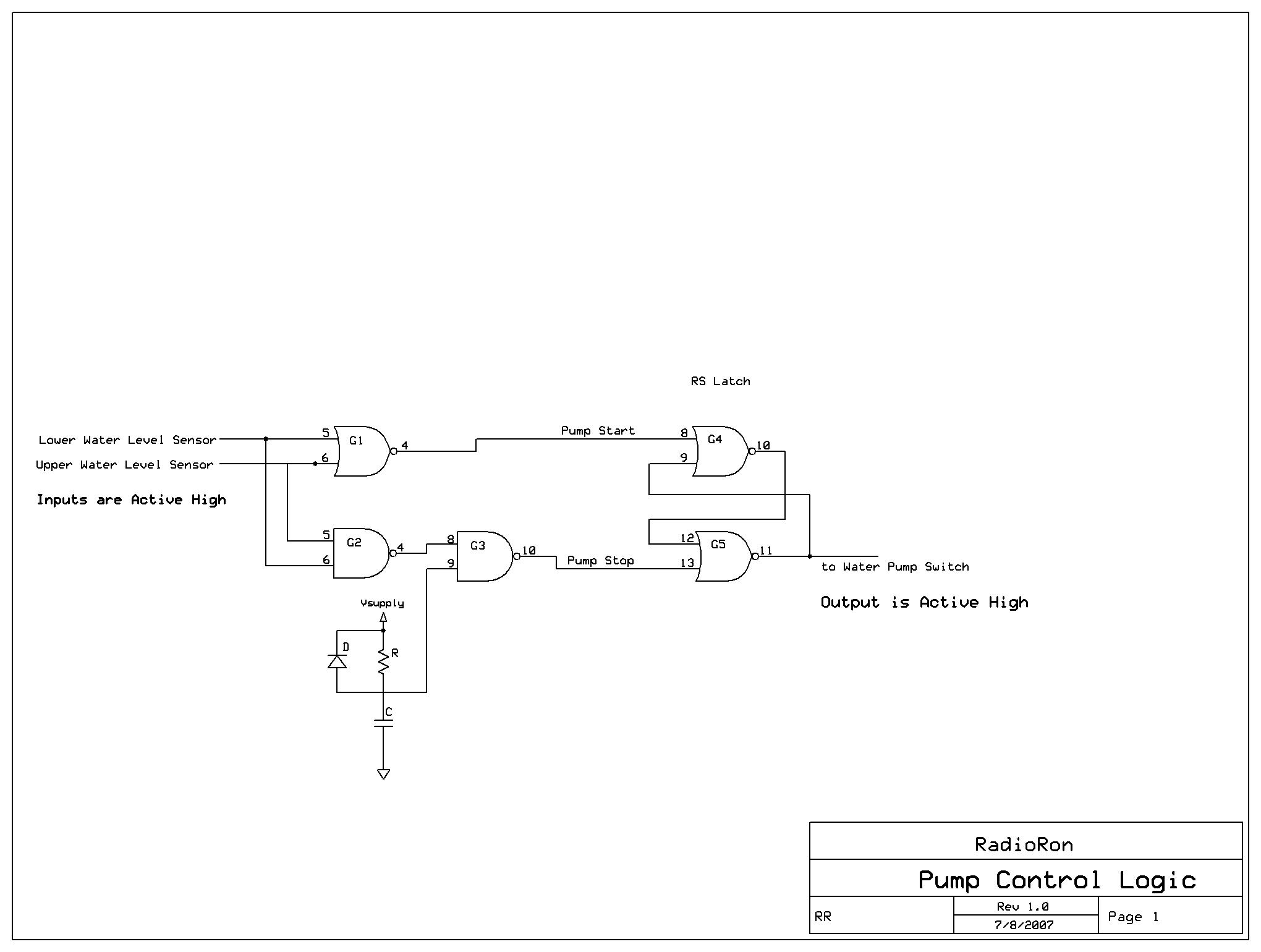

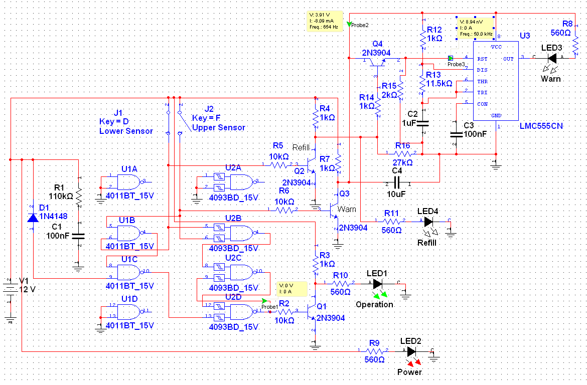

My Control Circuit
skeeterb
Here's the circuit as it stands. I'm still working on debugging it. RadioRon, would you please take a look at it and see if it matches the simple logic diagram that you posted to assist me on this circuit? It doesn't seem to be acting like its supposed to. It seems the output of the 2 ICs on my main portion matches the voltage of type of chip I'm using.I'm also getting some lower voltages from the transistors which is not desired. I need the voltage to be high enough to power the Warning LED, but as it is, the voltage is possibly too low to run it. It works fine when the Refill LED is illuminated. Otherwise, the 555 portion of circuit on the right hand side is fine. I need help getting the main part of the circuit straightened out. The attached picture shows what I mean by low voltages going to the warning LED and the 555 portion of the circuit.

It's a circuit that I have been working on for about a year and a half trying to get designed. Its intent is to control the operation of a hydrogen on demand cell. Also it is designed to indicate cell operation status with the 4 LEDS.
How should it work?
If I can get it to work right, the two switches that are labeled represent the two sensors that will be in the cell. when the upper sensor opens it activates the LED marked Warn. The cell continues operating until the lower sensor opens then it activates the refill LED, opens refill valves and activates a pump to refill the cell. Like I said I'm still debugging it and I wanted RadioRon, whom created the logic diagram to help me get started, to take a look at the circuit and see if I wired it up correctly to match the logic diagram that he posted for me.

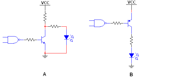

What is that LM555 doing there? I don't want to be mean, but your schematic is a bit confusing. Too many unused components.
LM555 Vcc is wired at the wrong place, wire it directly at 12V.
I think that you can do it with logic components only. Just a few transistors to boost output, if needed.
The 555 Timer controls the flashing of the warn LED when the refill LED is lit. It indicates that the cell is in the process of being refilled. It is controlled by the Warn (Q3) section of the circuit. I've been working on the circuit since I posted it and have changed some bits and pieces of it as I've been debugging it. I had to reduce the R7 (1K) from Q3 (Warn) to 500 Ohm in order to get the Warn LED to illuminate. I'm still attempting to get the output of the 4011 and 4093 to do as I want. That is what is bothering me.
For example. U2D that controls "operation LED".
Why are you using a NAND gate? You realize that you are inverting the NAND output with a transistor?
Use a AND gate with a transistor instead, with the LED connected in series with a resistor and the collector.
Same with Refill LED, you have a bunch of logic gates, why not use them to control that LED? You have Schmitt Triggers logic gates, use them to control that led as well.
Can you attach the Multisim file?
Ron made a RS latch with NOR gates, I do not see any NOR gates in your schematic.
Multisim File
Sure. Here's the file attached. I was recommended to use a 4093 and 4011 by radioron. Only the LEDs are controlled by the 2N3094 transistors. I needed it to activate the LEDs when the when the sensors are open. And in the case of the operation LED, the transistor illuminates the Operation LED when the sensors are closed. The setup I'm using makes it so when the input is high the output is low.

What I was trying to say was:
Use B.
That simulation file you sent seems to be working.

This circuit could be used in other applications other than controlling a hydrogen generation cell. That's just what I originally thought of using it for when I started working on it. I'm tweaking it so it does what I want it to do. I didn't realize the part RadioRon posted was doing what it was supposed to and kept trying to figure out what was going on. I'm also working on getting the Operation LED to turn on and off when both sensors are open. I'm getting there, but its slow going.
