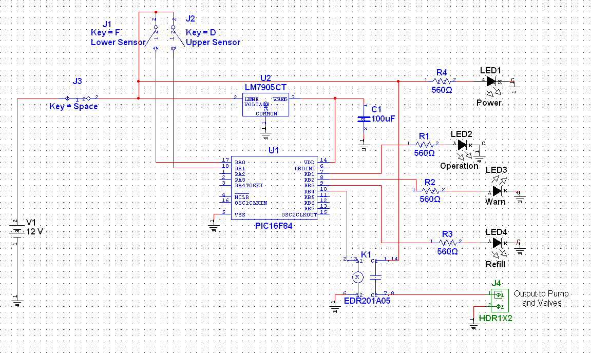

My Control Circuit
The 555 flashes the Warning LED when the Refill LED is illuminated. But when the Refill LED is dark, the Warning LED burns steady, that's the main purpose of the 555 chip in the circuit.
the basic summary is this
Up + Lower Sensor = 1; Refill = 0, Warn = 0, Operation = 1
Up Sensor = 0, Lower Sensor = 1; Refill = 0, Warn = 1, Operation = 1
Up + Lower Sensor = 0; Refill = 1, Warn = Flashing, Operation = 0
That's what I'm wanting in the indicator portion that I'm working on. I've got the warning and refill section taken care of, it's just the operation LED I'm working on getting to work in that pattern.

Hrmm, I hadn't thought of that. The indicator portion of the circuit is what seems to be causing problems now, hehe. Trying to get the indicators to work in the form of the simple summary that I gave is giving me headaches. I know you guys are trying to help me, but its difficult to try to get the point across at times. It's not you guys, its me. I'm not the best at trying to get what I'm trying to explain across to others. I've been playing with my design in trying to get it working, and it seems like a PIC Micro is getting more and more attractive as this form of circuit design is destined to fail. I may have to take your advice Blueroom, and use a PIC to do what I'm wanting. Designing the circuit around the PIC is something I have never tried and will give me a little problem, but I'll check out some of the examples that come with Multisim to see if I can find a design that may work. Which is the best microcontroller to use for my project?
Sometimes a uC solution saves you from a big headache.
Try to write everything you want and see, if a simple or a more complex solution is required.
It does really simplify the circuitry. I've already set up the output and the 2 inputs. Now if I can get the setup to program the PIC and to see if I need a crystal to control the microcontroller.

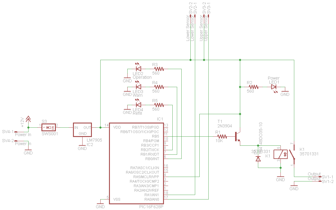

The ancient 16F84 has long been replaced by the cheaper 16F628. You'll need to put a transistor and diode on that relay though and pull up resistors on the switches. Plus the 84 needs an external osc where the 628 comes with an internal one.
Yes.
And we must not forget to debounce the switches, if they are mechanical contacts sensors.
Then may I suggest the 18F1320 with Swordfish BASIC SE as your compiler.
Easy peasy to code with.

Okay, which PIC to use? :) First you recommend a 16F628, now you're recommending a 18F1320. Every time you recommend a different PIC microcontroller, I go looking for the datasheet for that IC. I'm having to use Eagle to build the circuit around that PIC, because Multisim does not have them in the database.
It's the software that determines the PIC, the 16F628 has a few decent free compilers such as Great Cow BASIC, PIC BASIC Pro (not sure if it supports the 628 but their website will tell you what PICs the free 40line version supports).
