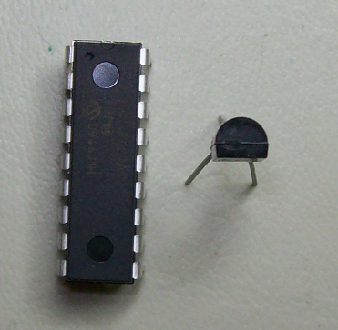

Takes up less space!?! Here is a picture I just took of a DIP18 PIC next to a TO-92 BC548.

i meant if i got the same number of transistors, as the chip has ''channels'' say my uln 2003 has 7 ''channels'' takes up less space than 7 transistors, and it's all in a regular IC footprint.

There's no need to get into a "mine is smaller than yours" debate here! I am very pleased with the outcome, considering the other day I didn't even know such a thing existed and - thanks to the Internet - I got all you helpful guys helping me, I ordered two to test, they arrived, they worked and now I've ordered a tube of ULN2003ANs to even further simplify (-2 pins). It's a real result. And my approach - and amando96's - is not anything against transistors 'cos, as we've discussed, these are transistors.
