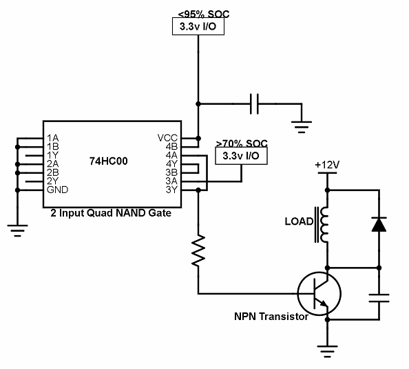

Howdy,
I'm an aerospace engineer by education which means basically a mechanical degree with a fluid specialty. And I'm a biotech engineer by work experience. In other words, I don't know the first thing about electronics, but I'm pretty good with Google so I can get in over my head real quick.
TLDR: This is my first circuit design and I may be in over my head. I have a logic circuit that requires the output of one nand gate for the input of a preceding nand gate and when I initially bread boarded it up, it didn't do what my truth table says it should. I've since fixed it but could use someone with a bit more experience telling me wether this looks like a viable solution.
Problem:
I installed a big Lithium battery bank in my RV. It's great, it will run my roof air conditioner for a few hours and with solar, I can stay in the woods indefinitely. But my brand new 200A Bosch alternator died shortly after I did the Lithium install and alternator upgrade. My wife does several solo trips cross country for business so getting stranded in the middle of nowhere is not a great outcome. When I took the alternator to a repair shop, it had a failed pulley clutch.
Root Cause Hypothesis:

My design:
I decided to go the digital circuit route since I believe this, if designed well, will be more reliable than an arduino based solution.

With a little help from http://www.32x8.com/var3.html I created the following logic diagram which I converted to all NAND gates to allow the use of a 74HC00 logic IC:
Awsome! That looks simple enough.
So then I Google the data sheets on the 7400 ICs and learn that they don't operate at 12 volts and that they won't drive a 200mA relay. Next I Google voltage regulators and watch youtube videos on NPN transistors and come up with this design:
I probably should have labeled my schematic, but it's late and I've been up all night, so you've just have to trust that I can accurately look up data sheets and calculate the resistor sizes needed for a given gain for the NPN. ( Note, the 74HC00 is a wimp so I chose a transistors with pretty large gains). I don't understand all this stuff but the 74HC00 data sheet recommended the capacitor and not letting unused inputs float so added a .1uF capacitor and diode to the voltage regulator. This really feels like overkill but I saw somewhere that is was a good design practice. It makes more sense with the high inductance load of the relay coil so you will see a smaller capacitor and diode there.
I bread board it all up and immediately smoke my 100 mA voltage regulator. The 5v circuit shouldn't draw more than maybe 20mA so I'm suspecting I either installed it backwards or perhaps the .1uF capacitor was too large? I replace the regulator with a larger 700mA (1.5 A peak) 5v regulator from my local electronics shop and it's stable and stays cool. Unfortunately, in the scenarios when the logic is depending on the feedback from the last NAND gate, the output to the small motor that I'm using for a load warbles a bit as if the output isn't entirely stable. If I remove the feedback loop between 3Y and 2B and feed the 2B input directly from the 5v or ground busses, the output is much more stable.

Is this just an issue of me not changing the input lead wires fast enough and the IC inputs float too long or is there a bigger issue with this feedback concept in general? If so, what's the solution to this issue? Do I try to slow down the voltage decay in that feedback loop long enough to keep the circuit from changing states? Given that that leg is also feeding the transistor, I suspect it decays pretty quick. I've started reading up on latching circuits but I can't make much sense of it. Maybe I'm out of my depth or just need some sleep.
Any advice on this main question or feedback on the rest of the circuit design would be greatly appreciated.
Could well be. It is a no-no to let CMOS inputs float. The IC behaviour becomes unpredictable. If you are going to swap leads around manually while breadboarding (and be aware that CMOS ICs are static-sensitive), at least connect those inputs permanently to one or other power rail by a high value resistor (say 1 MegOhm).

I don't think you need the capacitor across the NPN's source-drain since the diode across the inductive load should be enough. Make sure to use a fast diode.

For floating inputs and such, you can connect a resistor between each input to ground (or the voltage supply rail of the chip). Just make it a high resistance so when the active device tries to drive the line, it doesn't have to work too hard to overpower the resistor. 10K-20K is probably okay for a CMOS device which the 74HC00 should be. Or even 1Mohm as alec_t suggested (that seems really high to me though).
Don't forget to decouple the ICs. You place a 0.1uF ceramic capacitor as close as possible to the power and ground pins of the IC. I would use the X7R ceramic since this is for something like an RV that won't always be indoors. The actual value and type aren't too critical since it's meant to just provide a momentary reserve charge supply close to the chips when they suddenly draw a spike of current since the battery/power source is slow and usually far away separate by wire inductance which prevents it from providing current fast enough to keep up with the IC.

The 74HC00 input H switching threshold voltage is almost the same as your 3.3V input signal when the supply is 5V. Then the switching will be erratic.
Then use a higher input signal voltage (maybe 4V) or a lower supply voltage (maybe 4V).
With the 5V supply, an output H current from the 74HC00 is easily the 25mA maximum allowed current.
Why do you talk about the gain (hFE) of the transistor? The hFE is used for a linear amplifier transistor that is never saturated. But you want your transistor to be a saturated switch and the datasheet for most transistors show the base current is 1/10th the collector current regardless of the hFE.

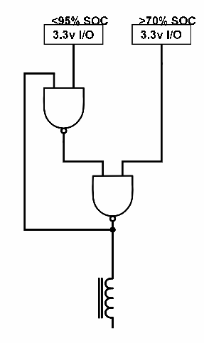

Hint: you show the 74HC00 as a box instead of as four 2-inputs NAND gates. I think your gates are a cross-coupled set/reset circuit.
That helps explain why I was having trouble grafting on a latching circuit. I had inadvertently already built one.:cool:

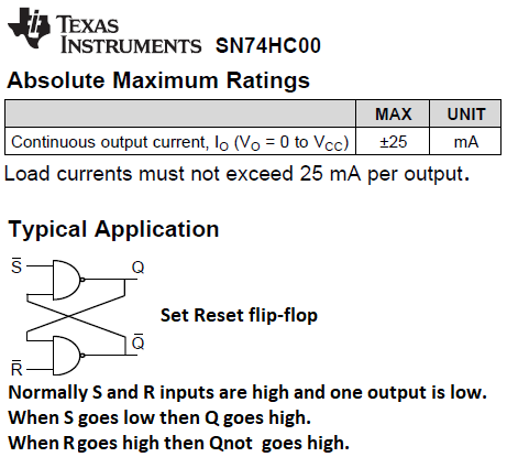

Does the coil of your relay use 200mA at 12V? Then it uses more at the 14.4V from a charging car battery.
What transistor do you use that has an hFE of 400 to 800 at 200mA or more? What is its saturation voltage and recommended hFE when saturated?
You are using the transistor as a saturated switch then you must use the base current shown on the datasheet when saturated.
Here is the datasheet of the 74HC00 high current Cmos gate IC:

I measured the relay current with the engine running and saw 209 mA so it’s probably close to its max but adding in some margin to account for voltage fluctuations sounds smart.
Since I misread the limits on the 74HC00 IC and didn’t understand the need to saturate the transistors, I’ve probably not made very good selections. I currently have a NTE 16006 in the breadboard but I also picked a NTE 13 off the shelf at Fry’s that I have played with.

Do you understand how the flip-flop 74HC00 works? When one input goes low then the flip-flop flips.
Do you know what the input logic does? I ask because you show gate 1ABY wired as an inverter but the other gate 3ABY input has no inverter.

The NAND gate Flip Flop triggers on a low voltage set and reset and the way I had my charge controller programmed it was sending a high voltage output when the State of Charge was >70 & >95%. To make the flip-flop circuit, the >95% would need to be <95% which is why my circuit had the inverter on the >95% input.
Not knowing about flip-flops, I still came up with the same circuit. :) And the output of the test circuit matches my truth table so I was happy because it used fewer than the 4 NANDs on the 74hc00.
If you look at my first logic diagram, that essentially came from entering the truth table into the 32x8.com here. The second simplified logic diagram is the result of converting all the logic gates in the first diagram into all NAND gates and then deleting all the back to back inverters.
And replacing the original block schematic version of the 74hc00 with the NAND gate version looked like this:
Where the >95% input is on 1A & 1B and the >70% input is on 3B
Having a better knowledge of basic logic circuits would have made things a bit easier for me but I still got where I needed to go. But all that may become obsolete as I've decided to alter the circuit a bit by ditching the voltage regulator and will now run the circuit off of the <95% 3.3v input. This means the circuit will always be powered when the battery is below 95% full so I need to make this a very low power circuit so it doesn't run down the batteries if the RV is parked for a couple months.
I'm therefore going to swap out the single transistor switch with a darlington pair so I can drive the logic and relay on less than 3 mA of input current. Or that's the plan for now.
And since I'm inverting the 95% input, I'll now only need two of the NAND gates and will have the true flip-flop circuit:
And here is the updated circuit:
