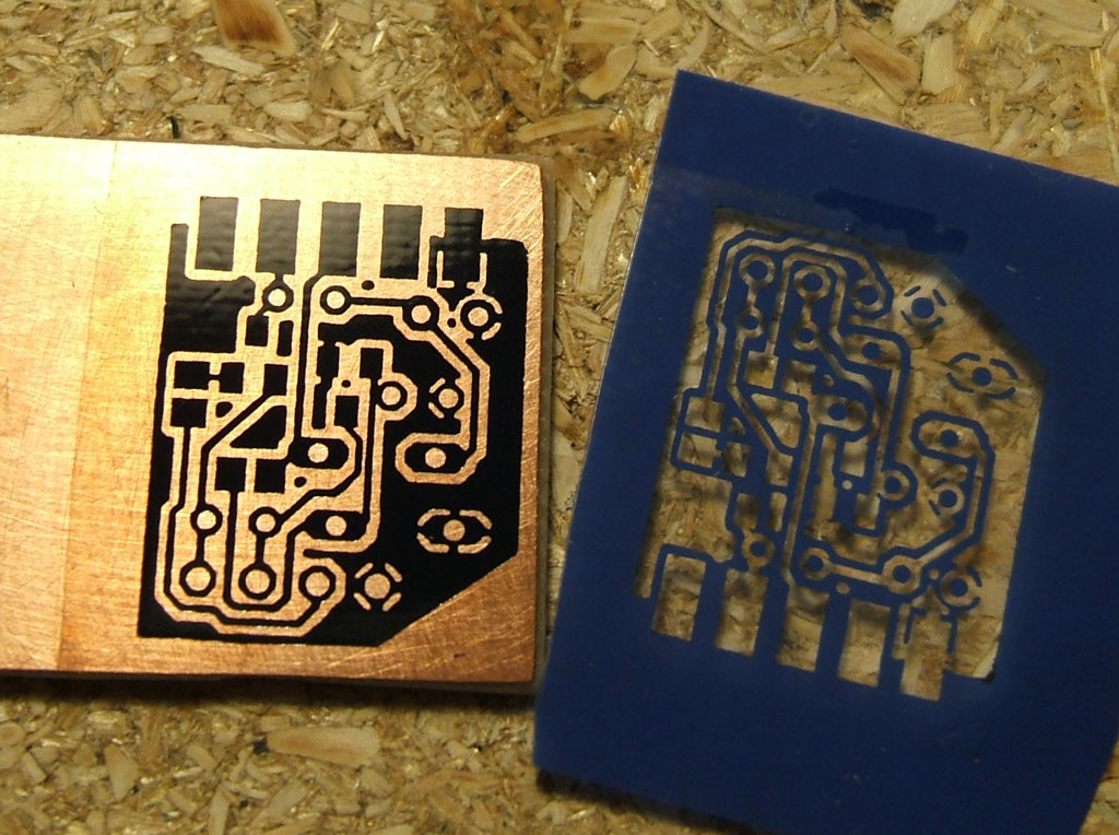

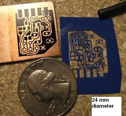

well, i prepare the copper board carefully before ironing the layout on it.
here is the sequence i use :
1-cut the board with 1 or .5 cm spare on the 4 sides, as heats usualy concentrate in the middle and is less at the end of the board.
2- scratch the board with sand paper, in 2 orthoogonal directions, till it brigh and shiny
3-use a clean towel and some organique solvant (i use "thinner"), and pass it on the board, each time changing with a new towel, until the towel is clean after you pass in on the board.
4-simply start the ironing process, taking less than 5 min with a 10X10 board.
5- leave the board with the paper on it in a bath of hot water for 5 or 10 min (preferably with some soab in the water)
6-remouve the paper by peeling it off, then with a tooth brush but try to be gentle using it!.
this is how i do it for more than 2 years now.
you have to adjust your printer the the maximum ink density.. (but i am sure you allready figured this out)
hope this help.

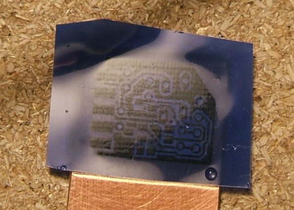

I use staples photopaper. I use my regular Inkjet to print on normal paper at the Highest Quality, then I run it though this laser printer which has a copier. Strangly, Even though most guides say to use the Glossy Side of the Photo paper, I found that your supposed to use the matte side (non glossy side) to do PCBs.
I found it out by accident when I was getting sticky goo all over the Iron, so I tried it on the stick side and it works. Once you have the PCB on the photo paper you just align it with your PCB, have the iron on the highest setting (I use water, Dont know if it makes a difference or not) and just press down hard. OH did mention you should have the PCB aligned with the PCB board with tape or something? If you dont, your PCB might come out crooked.
Then give it about 5 Minutes (move the iron around the board applying uniform pressure, but not so much that you rip the paper). Maybe give it 2 or 3 Minutes more Just to be safe. Once thats done you can use soap and some hot water to remove the paper. Ive found that if you peel one corner and put some dishwashing soap on to that open corner and allow it to seap in, the paper will be easy to remove. Ive also found that rubbing it onto the paper itself also helps. Remove the paper slowly under warm water.
Inspect for any damages to the board. Use a sharpie to repair any tracks that didnt come out. However, Maybe its me or my method or my tracks are too thin, sometimes they look fine after the paper is removed, but then when I etch it, some of the tracks start getting etched away.
