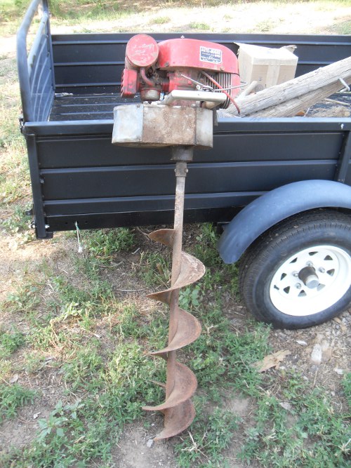

I have a 22HP tractor with a loader and a 3pt box blade. I also have a toeable backhoe. I enjoy both but I get more out of saving and fixing old, discarded, equipment. A huge amount of good nonworking equipment is out there. Stuff like this engine powered post hole digger rescued from the dump. It uses a 'Clinton' two cycle engine. To get it going I cleaned the carb, put an end on the spark plug wire, and fixed the hand throttle. It is still missing the correct recoil starter but I found one off a briggs lawn mower engine that works.

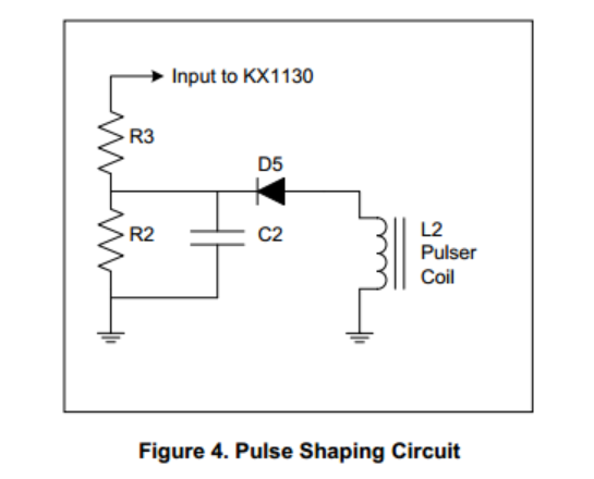

I want to look at the KX1130 Ignition Controller IC a bit further. I can see how they would work with a flywheel mounted magneto. They work with an impulse variety. It is nice that they avoid the points.
I can setup a pulse shaper with the magneto on the bench as per the diagram as it is the major bit of external parts. Maybe figure out what values are needed. Trouble is the required width of the pulse is in the datasheet which I did not find.

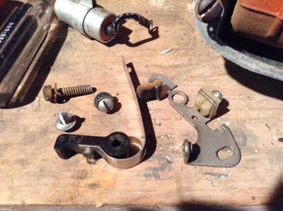

After attempting to clean and set the point on the magneto I took the point set out of the magneto and ran them through the ultra sonic cleaner with dawn dish soap and hot water. The points set is 2 parts so I lined them up under a magnifying lamp prior to setting the gap.
That did the trick. I can get a blue 1/2 spark and a heck of a jolt from the thing. For testing purposes I did not use grease, I still need to take the moving point off to lube the pin it rotates on. With luck that will go well and I can swap this fixed unit for the one on the roller. Going to see if I can fix that one as well. But that is going to have to wait for warmer weather.
What I have learned from this is that much of the web methods for testing magnetos do not work well with my digital meters. I qualified that because maybe they will work better for others.
