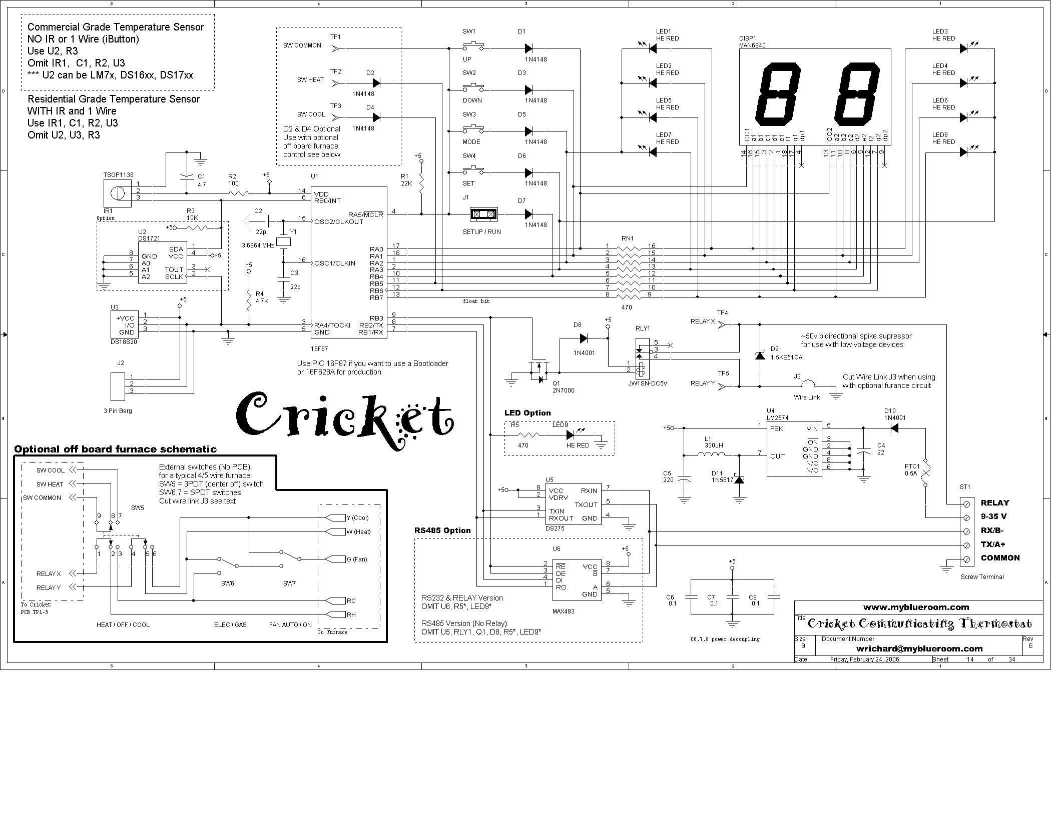

Cricket: (Addressable RS485 or RS232 Thermostat with IR)
My most popular design, (my favourite too) PIC16F628A
RS485 or RS232 multizone up to 9 using DS18S20 type Centigrade temperature ICs, single relay can control basic HVAC (see furnace option in schematic to control AC, Fan & Heat) can be expanded to 6 relays (heat-pump) using my Ladybug Automation Controller, other options include keypad, IR remote & 1wire, 8 zone LEDs plus 2 seven segment LED displays on only 8 I/O pins (Charlieplexing)

Looking for options and comments. (any help in PCB design & code snippits would me most welcome)
