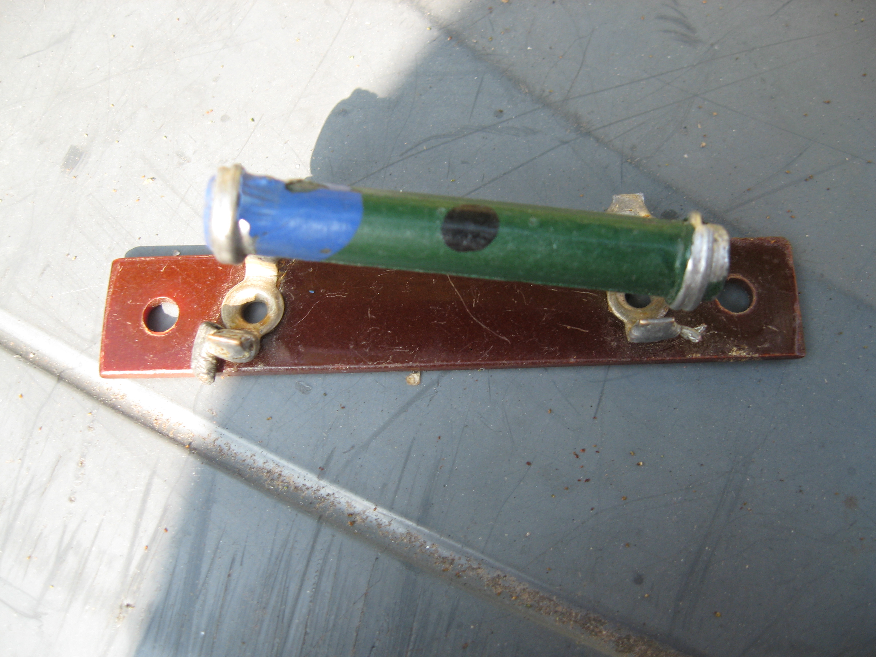

I have found one of those old style resistors in my junk.
This reads 56 ohms (Green 5, Blue 6, Black decimal multiplier 0) It actually measures 50 ohms.
The spot was sometimes a band in the middle of the resistor.

I was close then, that would make it body, tip, spot :D Not bad from memory.

I need to study these a bit. Are they 'old style' ?
VERY old style, no point in studying them unless you like playing with seriously old electronics - think probably pre-WWII.
As far as I'm aware they disappeared from use long before transistors appeared on the scene.
I suppose the only thing to 'study' is the order you read the colours in, as the colour code is still the same.
