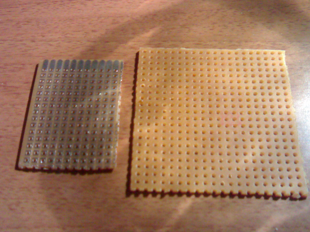

it is much of impresson that some of you guys don't know stripboards :rolleyes: they are damn cheap and easy to build circuits, i use them very often.. but if you dare try to build something with RF or and audio amp on these... :p
They are perfectly fine for audio, and low RF, no different to a normal PCB. Even for VHF they are OK if you design the layout properly (just as with a PCB), check Audioguru's VHF transmitter on stripboard.

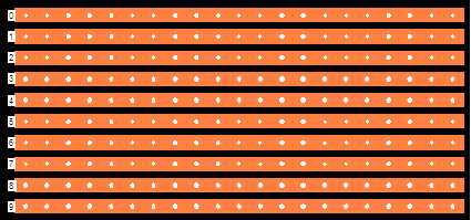

You don't know what is stripboard. You showed a pic of perforated board with a copper square around each hole. Then you need to solder many wires to join the holes together.
Stripboard has printed copper strips that already have the holes in each strip joined together. Parts and a few jumper wires are inserted in the holes to make the other half of the wiring. The copper strips are cut with a drill-bit or hand-tool then the strip can be used for more than one function.
peace audioguru! :D
i didn't knew that i used wrong english word for the board i'm using.
If my photo had only the non copper side of the board would you have said this? :p :p anyway thanks for the correction...
