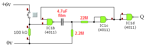

A time delay is roughly equal to the resistance times the capacitance. So your delay is only 1k x 1nF= 1us. If you want 10 seconds then use a 4.7uF film capacitor (an electrolytic has too high a leakage current) and a 2.2M resistor. Also, add a 22M resistor in series with the input of gate C to isolate its input protection diode.

Sorry, my circuit doesn't make a delay. Instead it makes a 10 seconds long output pulse. Re-arrange its parts to make a delay.
hi, i thaught that was the monostable circuit??
i did that circuit on crocodile tech. and nothing happened (Q still didnt change state)

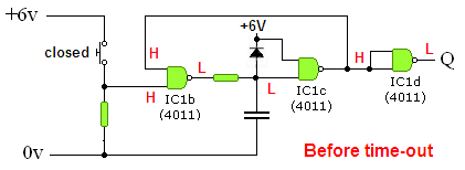

In my circuit, when the switch is closed then it makes the input of gate B high. The 2.2M resistor makes the input of gate C low so its output is high. Gate B then has both inputs high so its output is low and the capacitor remains uncharged. Because the output of gate C is high then the output of gate D is low.
When the switch is opened then the input of gate B goes low, therefore its output goes high. Therefore the input of gate C also goes high due to coupling from the uncharged capacitor. With the input of gate C high, then its output goes low which makes the input of gate B also low and also makes the output of gate D go high.
The capacitor charges through the 2.2M resistor until the input of gate C is low, causing its output to go high and also the inputs of gates B and D. Therefore the output of gate D goes low.

This circuit has a low output which goes high about 10 seconds after the switch is opened and stays high even if the switch becomes closed.
Reset it by shorting the capacitor with a switch.

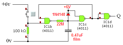

If you are talking about my last circuit, then the uncharged capacitor holds the input of the gate C low, so its output is high. Therefore the top input of gate B is also high. Maybe your diode is backwards. See this sketch:

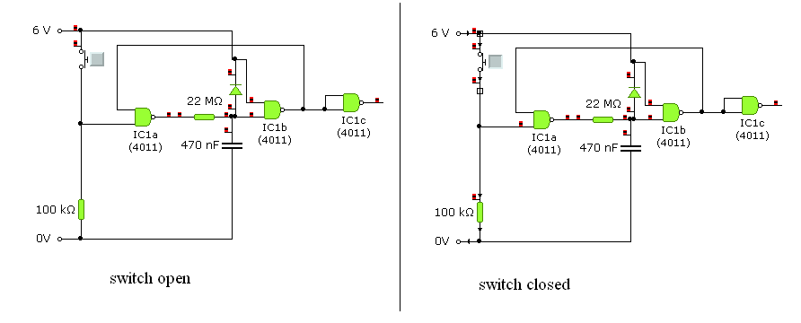

here is what happens with the logic, the 1st gate doesnt go high

You forgot to label what happens in your sketch.
Oh, oh. You re-numbered the gates so my previous explanation needs a translation.
The gates in a CD4011 are NAND. The output of a NAND gate goes high if any input is low. When the switch is open then the 100k rsistor makes the input of gate A low, so its output must be high. Then the 22M resistor can slowly charge the capacitor.
hi, just tried the circuit again and it works, Thanks for your help :)
