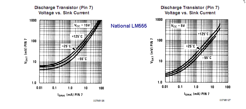

hi Al,
This is a clip from the National LM555 d/s.
The LM555 data sheet says, "The output pin can source or sink 200ma".
That data sheet also shows the discharge pin going as high at 100ma with around 1v sat voltage.
1) Output sink ability wasn't the question.
2) We don't know the sat voltage being used. But neither chart (later posted by Eric) goes above 100 mA. 200 mA at 2.5 sat voltage is "off the chart." In fact, at 5V, the max shown is in accord with the NXP chip.
3) This question was about the NE555, not the LM555. The LM555, while interesting, is off topic, as are the CMOS versions.
Now, I am not saying the NE555 cannot sink 200 mA at the discharge pin. What I am saying to those who claim it can is quite simple. That claim contradicts the manufacturer's datasheet. It contradicts what the manufacturer states about the internal design of the chip. Just show us what you did so the claim can be tested and verified. That is a simple principle applied across science and technology. If you do have data (with the test circuit used) to support that claim -- particularly any data showing long-term stability, heating, and failure rate at the claimed power -- just post it. Again, this thread is about the NE555.

What dont you understand about the pin 7 current limited only by the package power dissipation?
What the data sheet tells us is that you dont have to limit the current through the discharge pin, the internal drive/gain will take care of that. The only thing you have to worry about is the saturation voltage and the actual current you obtain. If you do have 100ma through the discharge pin then you dont want 10v saturation or else the package will overheat.
You have to realize that the discharge pin has built in overcurrent protection, but not any built in overpower protection. That's the bottom line.
If you are, on the other hand, looking for low saturation voltage at the discharge pin, then you have to think about limiting the current yourself by design. That's not the same as the max current the transistor can handle. These two specs are different. I think what you are after is a low saturation voltage with some decent current through the discharge pin, which you might not be able to obtain, but you wont burn up the transistor no matter what you do unless you allow it to overheat due to a combination of current and saturation voltage.
You have to also realize that when they designed this thing they made it so that you can connect a largish capacitor right to the discharge pin and the other end to ground. If the discharge pin did not have current protection built in it would burn out on the first cycle pulse the first time it was turned on.
If you look at the schematic, you'll see the discharge transistor driven with a 100 ohm resistor while the output sinking transistor is driven with a 120 ohm resistor. Not much difference, with the discharge transistor being driving just a little harder.

Hello again,
I asked you a simple question, what is not 'professional' about that?
It appears that you are after a different kind of spec here. You're not that interested in knowing what can blow the transistor out as much as how well it will perform when used in an application within its limits. The information i supplied says that the transistor wont blow out, that's all. It doesnt say how well it will perform as a shunt device when used in a normal circuit. That's about all i can tell you right now because i dont see any other data anywhere that is going to tell me that if i use a 100uf cap how fast it is going to discharge due to the internal current limiting action of the discharge transistor, or at least not to any exacting specs.
However, from the LM555 data sheet we can see that for 80ma the sat voltage is about 1v (roughly). That says that the internal R at that point is 1/0.08 which is 12.5 ohms. This sounds like something they didnt want to spec too closely though, and it's even hard to judge the repeatability. It most likely has a lot to do with the beta of the transistor and possibly other factors.
The best we can do seems to be to go over the analysis for a particular application and see what effect larger or smaller resistances will have here.

Hi there alec,
Oh ok, that's more like it :) Now i have a much better idea what kind of information you are after. It appears you want to know the longevity of the 555 ic when subject to a large cap where it is questionable whether or not it's going to survive. That's a very valid question.
This really involves at least two things...
When we look at the data sheet we see that they do show some specs for the current, and they do show about 80ma at 1v for the discharge pin. What they dont show is the absolute current level limit. I dont know if they actually could spec the chip like this because it probably varies a bit from chip to chip and also with temperature due to the way bipolar transistors work with attention to the beta variations. This means one chip might draw 100ma and the other 150ma. It's very hard to put an exact number on this because of the possible variations. This in turn means it would be hard to determine how long a 1F cap would take to discharge down to say 0.1 volts when it starts out at say 15 volts.
What we can turn to is the power heating and see if that helps.
At 15 volts and 100ma that would be 1.5 watts, which would cook even the best package type i think if it ran for a long time that way. It only discharges for a limited time however, so we have to look at that.
With 1F and 100ma
dv=i*dt/C
dv=0.1*dt/1
dv=0.1*dt
15=0.1*dt
dt=150 seconds.
Thus it would take 150 seconds to discharge the 1F cap at 100ma.
So the question then becomes, would the package overheat in 150 seconds? It's hard to say without knowing the thermal time constant. I guess we could estimate that, but for now lets assume that it wont overheat in 150 seconds because the average power is about 0.75 watts over that time interval, and we wont retrigger until we force the average power down to 300mw. 300mw is chosen based on the thermal resistance of the 8 pin plastic package and the fact 600mw will cause a temperature rise of about 80 deg C, and we have to limit to a package rated at 70 deg C max.
So given the 1.5/2=0.75 watts and the target limit of 0.3 watts, we get the duty cycle of 0.3/0.75 which equals 0.4, or 40 percent. This means that since it takes 150 seconds to discharge we can not retrigger again until 225 seconds later, for a total cycle time of 375 seconds.
Now that was for 100ma, but if it draws 200ma that means we discharge in 75 seconds. This means at first it appears that we can retrigger 112.5 seconds later, for a total cycle time of 187.5 seconds.
However, the power increased to an average of 1.5 watts over the discharge time period, meaning now we have to limit to 0.3/1.5=0.2 or 20 percent duty cycle. This brings us back to a 375 second cycle time, even though we discharge faster now.
You might start to see the differences here and the similarities.
So in the end we end up with a little formula:
cycle time tc=C*Vcc^2/(2*0.3)
Of course this assumes that there is no significant dissipation caused by any of the other pins, especially the output pin. If there is, then that has to be subtracted from the 0.3 above:
cycle time tc=C*Vcc^2/(2*(0.3-Pd))
where Pd would be the output pin power, subject to a limit of less than 0.3 watts.
I think this now explains how the limitations of pin 7 come into play through the power dissipation of the chip.
