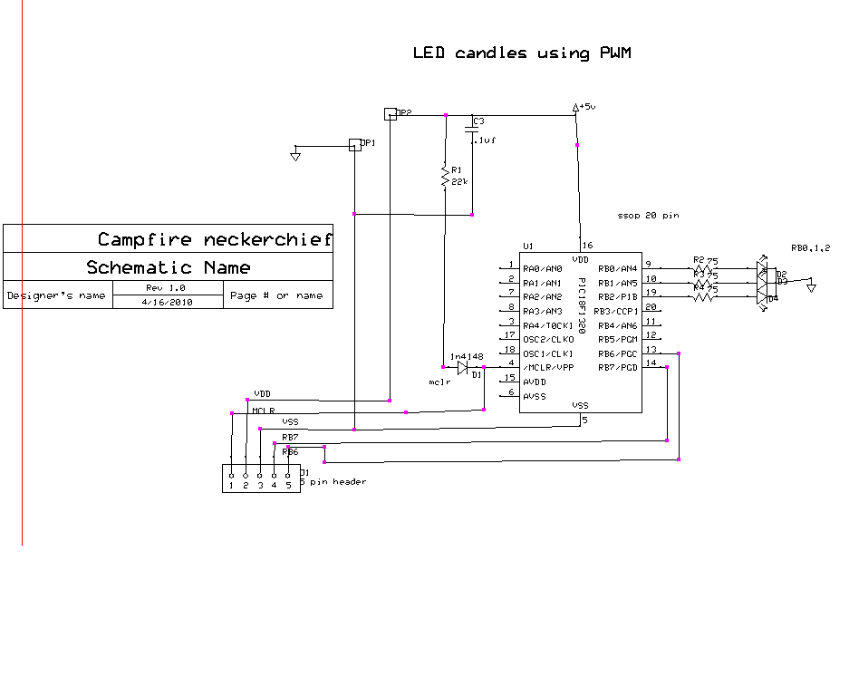

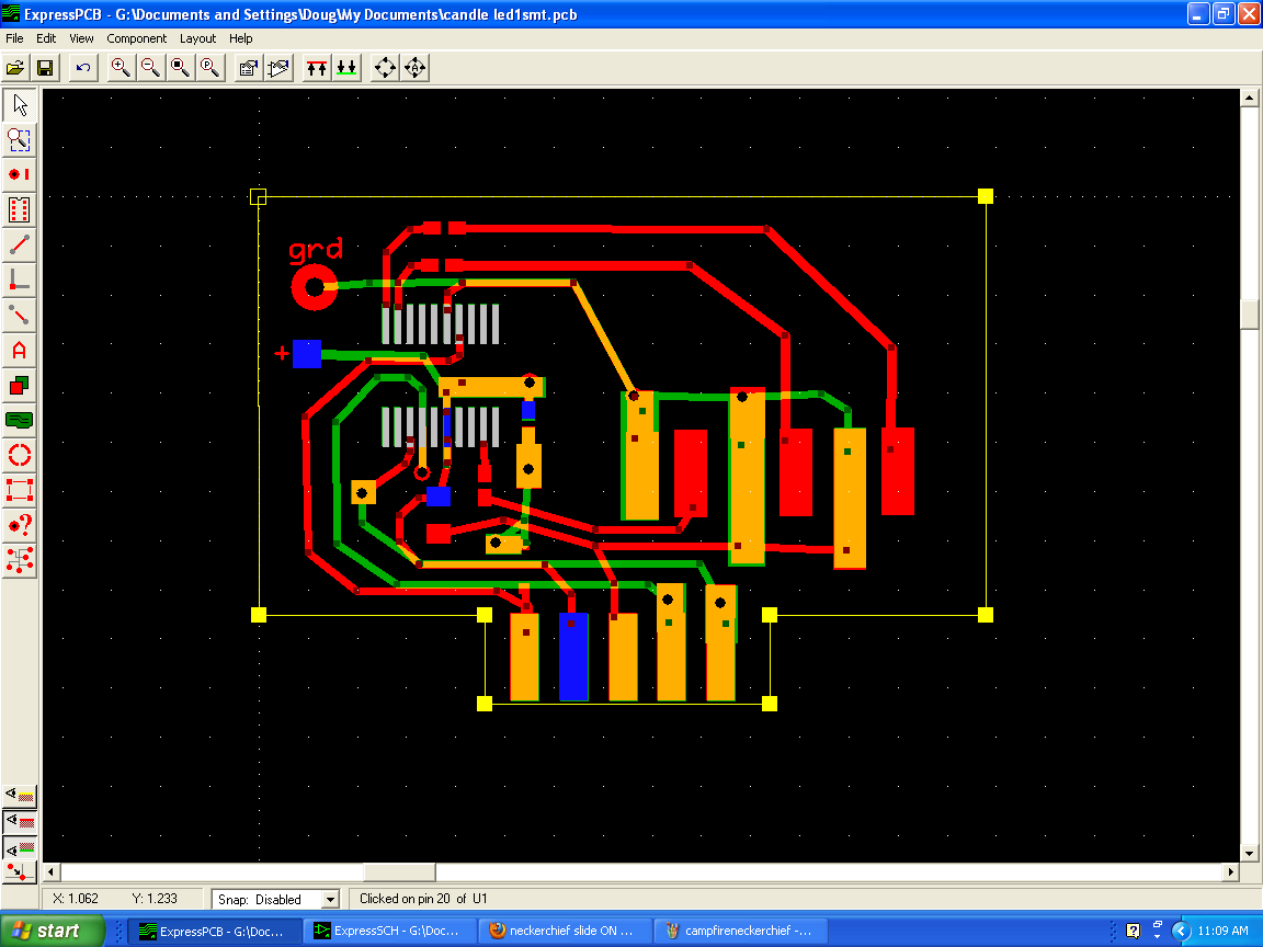

schematic and pc board SMD
My second SMD pcboard. Hopefully have it right.
several vias and first time using SMD resistors etc.

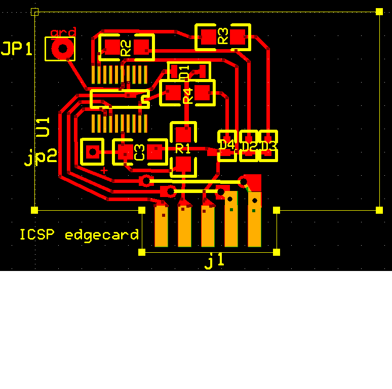

Revised PCboard w/SMD
revised board seeing how I picked thin film instead of thick film resistors (WAY CHEAPER)
made some changes so now its only a 1x board with 2 jumpers.
not real sure about the ICSP edge card but should work?
