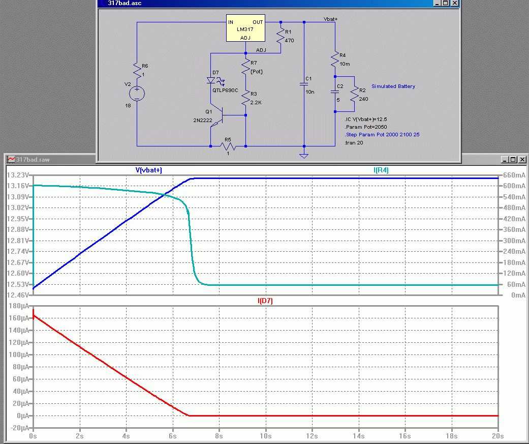

While looking online i found this neat circuit which incorporates a LED for status. I built it and while i can tune the circuit to give me 13.4V using the pot , no matter what i do or connect the LED wont come on ? The explanation states the LED should be on when the current is at max, which i believe happens when one connects a dead battery ?

Any ideas suggestions ?

The LED monitor circuit doesn't work as drawn because the current through the LED is too low to light it. Look at this sim., particularly the current through the LED I(D7).
V2 and R6 simulate a transformer, full-wave rectifier, and filter capacitor. R2/C2 (yes, that is 4 Farads) simulate a battery, where R2 is leakage, and C2 simulates the electrochemistry jiggered so the battery "charges" in seconds instead of hours.
In the Plots, I(R4) is the charging current. V(bat+) is the battery voltage. I(D7) is the current through the LED.
ps: I just noticed that I was posting to a year old question. Oh well, maybe someone will get something out of it.
