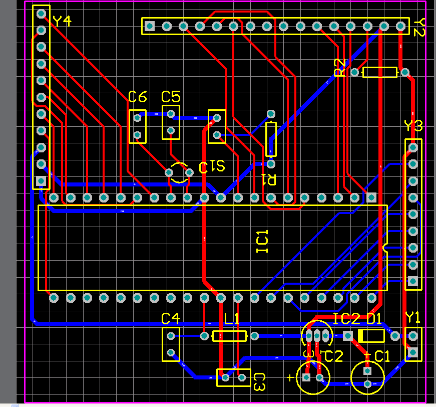

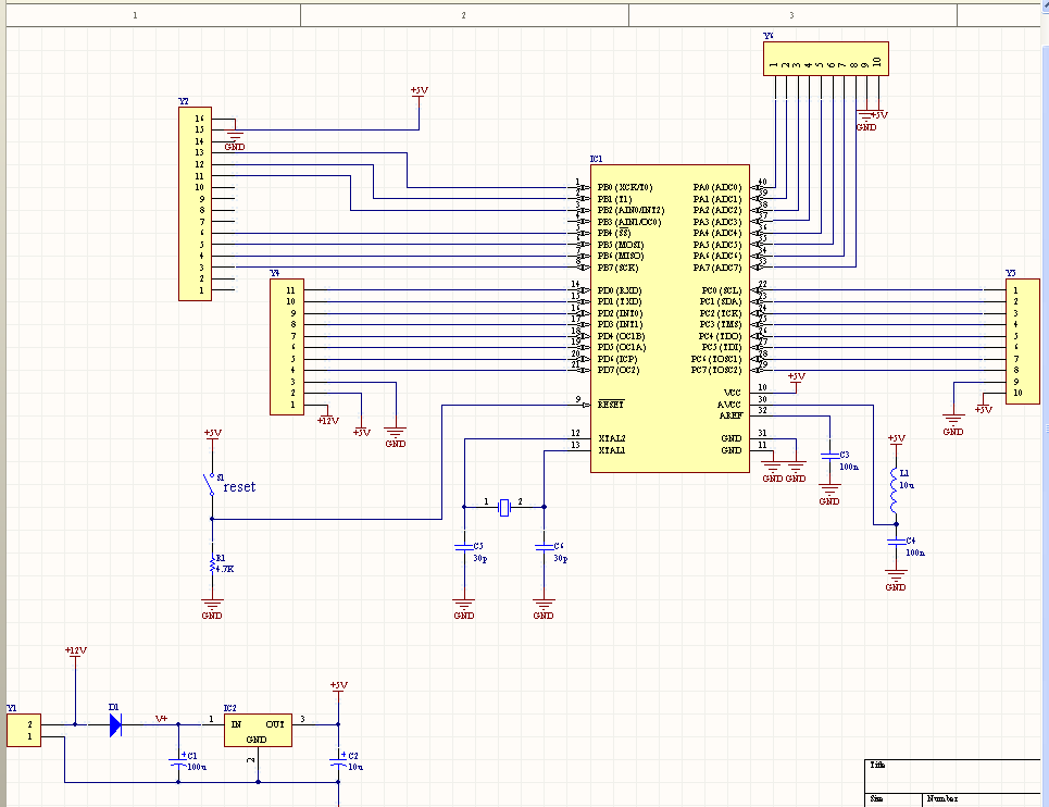

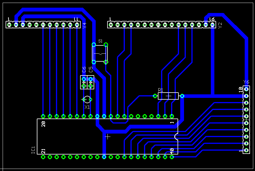

need a help with PCB.
t.man
can anyone come to my rescue.
i'm making a pcb with Altium Designer 6.9. i'm trying but i'm exhausted now.
this is what i've done( attached).
can anyone transform my schematic to a nice PCB.
Kind Regards,

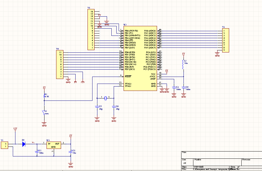

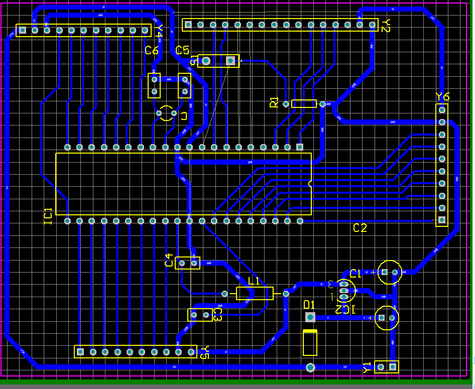

another try, now single sided...any comment?
the upper side (which invloves oscillator, switch,etc..) gives me hard time now...i need someone's help
another thing, how do i make 12Vdc power jack( to replace Y1) using Altium designer?
Hi t.man,
a PCB design depends a lot of how connectors have to be used. If the connection sequence is fixed (e.g. connector for an LC-display) the connector pins must be connected in the same order the display requires. Other connections might vary according to the easiest (aimed for single layer) way of routing.
Your latest (single sided) example shows a big gap to fill to complete the PCB design single sided.
Getting too close to the screen you won't see it (at least not easily). Stand back a bit and take a sharp look. The gap is exactly where you wasted precious space. :D
Boncuk

Here is my comment. Why do you use a grid size not matching standard pitch distances or a fraction thereof? (1/10, 1/20, 1/40, 1/80. etc inch)
Take a look at your pads and traces off grid. They are crooked.

can you lend a hand and give it a go?
Of course I can and I will.
The software I am using is Eagle. I'll take your latest picture and do the changes using that program.

IC1 is atmega16
...and you can play around with the circuit as you wish, i.e add ISP Header, etc..

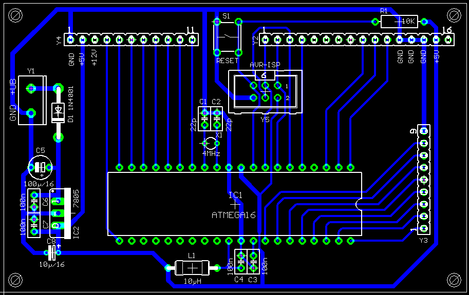

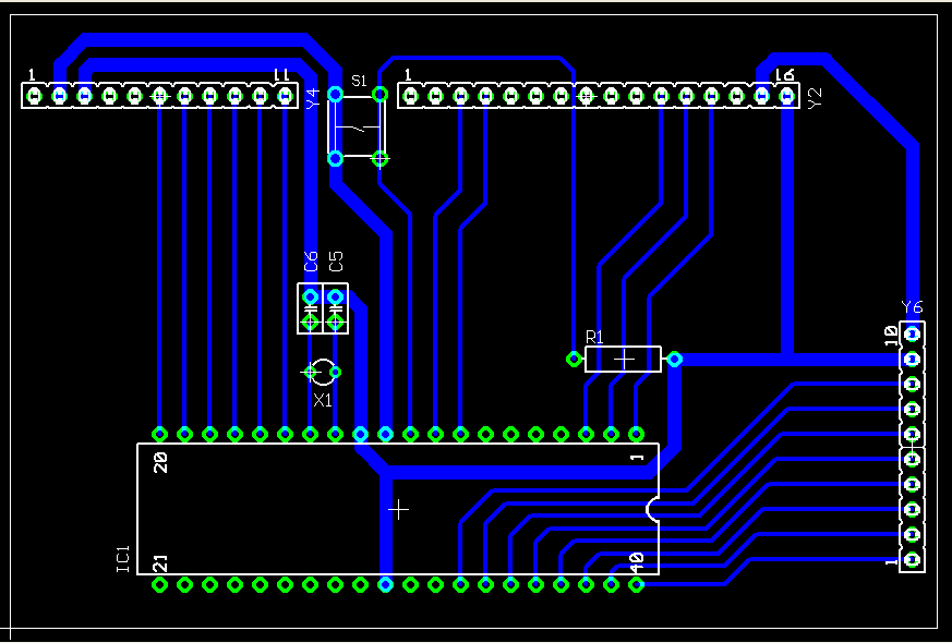

Hi t.man,
here are two ways to route the reset button to R1. There is still a third option moving R1 to jump across VCC and route the left pin back to S1 using the space between connectors Y2 and Y4. In that case S1 has be mounted oriented vertically.
I'd prefer solution one since the reset button is not obstructed by connectors.
I omitted the bottom part (everything 'south' of the MCU).
Be advised that schematic and PCB are not consistant, causing problems when trouble shooting.
Boncuk

Nice work Boncuk! R1 could be place just below S1. and Ground could be taken to Y4(pin3) from middle of the IC eastwards and then vertically UP, instead from the Capacitors point to avoid interference.
thanks for the flowers msv sarma,
I guess the application isn't time critical (so many port pins used).
Anyway these suggestions are certainly not the final descision about the design.
Generally I pay extra attention to the crystal and its capacitors for an undisturbed ground connection, if necessary an overall ground plane on the component side.
Boncuk

Hi t.man,
I've made a new board design using all parts contained in your schematic + an ISP connector.
The +5V connection at Y2 is not quite clear. Is it connected to pin15? Labels are normally placed left or on top of a pin. This one is underneath the pin meaning a dead short since it also is connected to ground. Also the ground connections to Y2 are not clearly recognizable. As I understood (also due to a missing junction) pins12 through 14 are connected to ground.
What frequency does the XTAL have and what kind of diode is used for D1? For the voltage regulator I assumed an 7805, also no value printed in the schematic.
Boncuk
PCB layout
