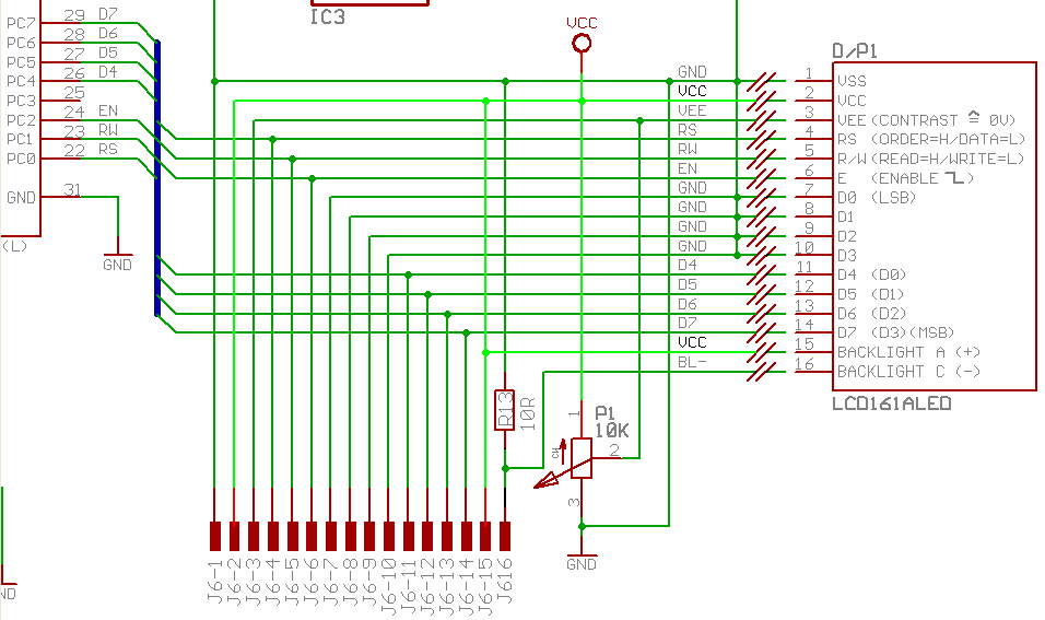

I've made a new board design using all parts contained in your schematic + an ISP connector.
The +5V connection at Y2 is not quite clear. Is it connected to pin15? Labels are normally placed left or on top of a pin. This one is underneath the pin meaning a dead short since it also is connected to ground. Also the ground connections to Y2 are not clearly recognizable. As I understood (also due to a missing junction) pins12 through 14 are connected to ground.
What frequency does the XTAL have and what kind of diode is used for D1? For the voltage regulator I assumed an 7805, also no value printed in the schematic.

D1 = 1N4007
XTAL= 4MHz
voltage reg= 78L05
sorry for Y2,
actually i was connecting it to suit my needs, i.e for the LC-display....
LCD pins arrangement: 14-13-12-11-10-9-8-7-6-5-4-3-2-1-16-15
with pin 1 as GND and pin 2 as voltage supply and pin 3 contrast adjust.
file attached.

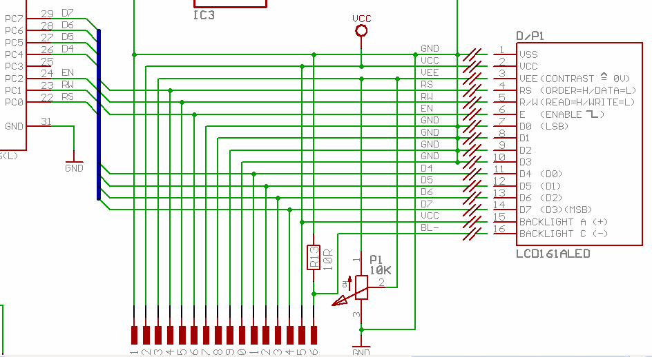

connector Y2
Hi t.man,
I just checked the schematic and according to your pin arrangement of Y2 it would look like this: (values in paranthesis are true values for normal connections)
14(1), 13(2), 12(3), 11(4), 10(5), 9(6), 8(7), 7(8), 6(9), 5(10), 4(11), 3(12), 2(13), 16(15), 15(16)
To proceed with the layout there is some info required, mainly because there is an obvious error in connecting the LC-display. At least one data line is missing.
Please label all nets in and out of the MCU. This isn't only helpful for proper layout planning, but also useful for trouble shooting.

I feel the contrast Potentiometer pin1 should be to Vcc and not to Vee , though some people connect a sing le resistor from Vee to ground. In such case the pot is not needed. perhaps the designer should address this aspect.

better now?
the cross pinning shown is perhaps not correct. I saw and heave these 1602 models. the pins order is shuffled and datasheweet is tallying with what LCD panels I have.
Seceially to mention that pins 1 to 14 are shown right to left and 16 and 15 follow at the right of pin1. If, J6 is the connector meant for this 1602 type , thw wiring order is to follow the datasheet perhaps. if JHD type is used, the connector works straight.
the Contrast mod appeared OK.
i missed an observation that the limiring resistor is conventionally kept on LED+ (pin16) but it is now on 16/ should not matter seriously but might confuse others at the edge connector shown.
You have indicated that "atleast one dataline is missing" which wire Boncuk?
Normally LC-Displays are driven in 8-bit or 4-bit mode. Obviously the 4-bit mode is selected. However that requires nets to pins 4(RS), 5(R/W), 6(E) and pins 11 through 14 (D4..D7), besides VCC, VEE and ground + back light connections. Counting the nets there is one missing.
The current limiting resistor is placed into the ground connection because I use it as a jump in my PCB-layout. :)

You may have to consider - back lit as another pin. this the count is complete.

Go ahead and solve the riddle with 'diced pin numbering' and the unlabelled nets. :D
The LC-control connections are non-standard. Normally the display is connected to port C.
There is no riddle and I use this kind of LC displays Boncuk !

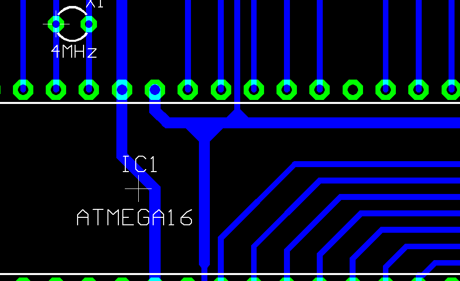

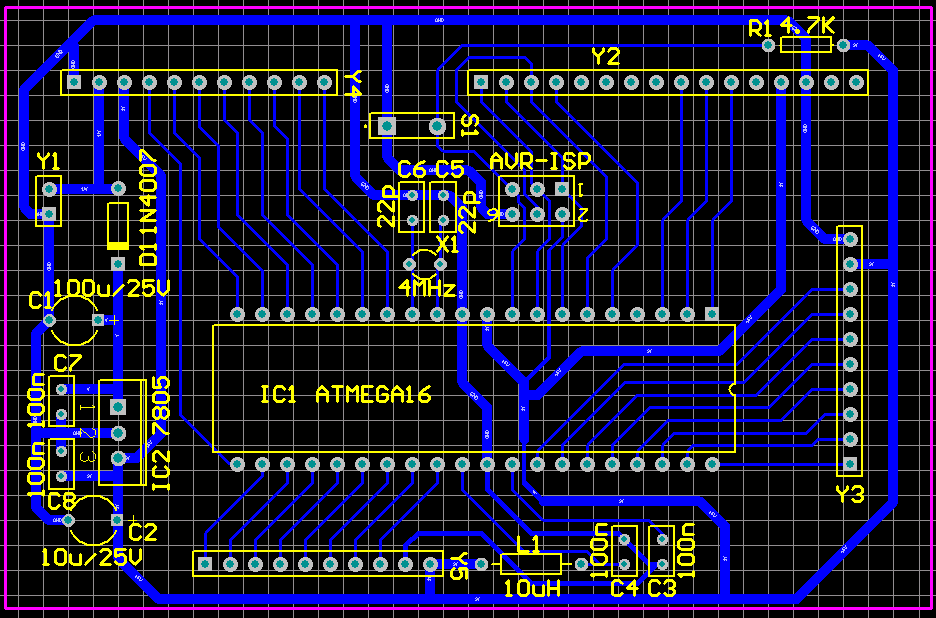

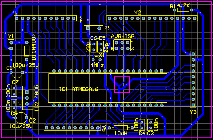

hi Boncuk,
following your layout, i've been able to come up with this:
what can you say?

I had preferred you come up with a revised schematic having labels at the nets.
The layout looks OK so far with the exception of the "Christmas tree" underneath the ATMEGA16.
There is a more elegant way to route the traces.
Boncuk
