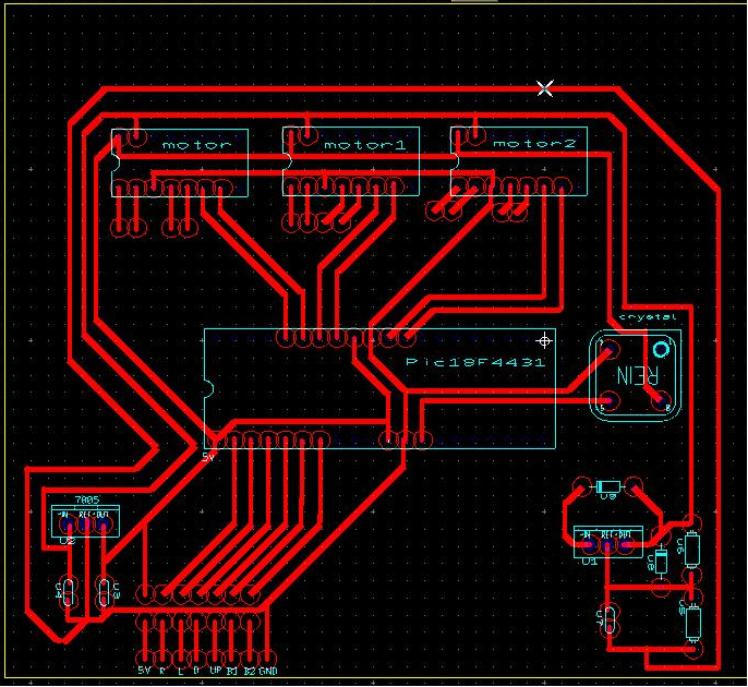

Hey, I'm building a model of a construction crane. Using 3 Step motors, 3 step motor drivers and a microcontroller. Also 2 voltage regulators. Gonna use a joystick to control the step motors.
Well...anyway I'm wondering how the Step motor drivers work and where to connect the step motors. Since the step motors usually have 4 wires, (2 bright coloured and 2 dark coloured). But which output pins on the PDB??

Here is what I've designed so far:
Step motors with just four wires require a bipolar driver. However, the PDB3517 is a unipolar driver. Unless, the motor has leads for unipolar operation (5-6 leads) you can't use them on PDB3517.
Ckramer said:
Meaning 4 leads + 1 GND?
No. It's 4 leads + common supply.
A sample schematic is on the datasheet you just cited. Page 6 Figure 14.
Ok, Thanks! So if I have a motor with 5 leads, I connect them to output pins 1,2,4,5 and 13 or 14 on the PBD?
