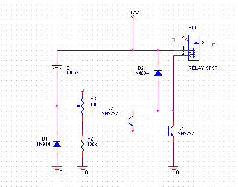

I think you just need a simple transistor circuit. I will draw one up.
Power comes on, relay comes on, 15 seconds later relay shuts off and stays off till the power is cycled again, right?
That would be wonderfull. Thanks.
Here you go. Not super accurate, but will save you headaches over trying to get the 555 to do this one very simple thing.

BTW - how are you turning this circuit "off"?
If you have something like a 12V wall-wart in an appliance timer, you may need to add a resistor across the power supply or NONE of these circuits will work.

I have a digital wall timer, that is programmable down to the minute, but for my application 60 seconds is too long of a time to be on. (It is for a misting system for a vivarium) So I needed something to cut that time down to anywhere between 5 - 30 seconds.
What resistance value would you suggest.
1k, 1/4w. Without it, the voltage may never really go all the way to ground.

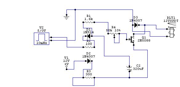

Thanks. Now believe it or not, I once held a degree in electronics. But that was like 15 years ago. :) I dug out an old program I had to make circuits. I traced out the original device I posted a photo of. But could not get it to work. I also tried your new schematic and couldn't get it to work either. Dunno maybe I wasn't doing something incorrectly. Here is the Tm15 if anyone wants to look at it. I also download a trial of the old workbench tool, its called multisim now. Coudln't get it to work with these circuits.
I tried it this way, as having all these failed projects is getting pricey.

I built the circuit I showed you and it works fine.
Build the circuit and try it with Multimeter.
Need more than "couldn't get it" to help you. And I mean actually build it with wires and all, not on a simulator.
The collector of the final transistor should start at 0V, stay there several seconds, then go up to 12V. The base of the first transistor should be at 1.4V, stay there several seconds, then drop to zero. What are you getting?
Oh, sorry. I meant that from my previous posts, that all these "physical" builds are failing and its getting expensive to "test" so I went digital so I can see it doing what I want before I invest in building another physical device. Now I bought all the parts from your diagram with some exchanges. Here are the parts I have.
Instead of a 1n2222, I have ecg123a
Instead of 1n4004, I have a sk3017b
all the other components are as given. Sorry If I was vague earlier. Just pulling my hair out for something that should be so simple.
BTW, I did assembly it on a protoboard and it didn't do anything. The relay never tripped. (my multimeter's batteries died so i couldn't take readings.)
Get batteries for the multimeter. You are flying blind without it. Could be the power supply is dead, or something's hooked up backwards, or anything.
