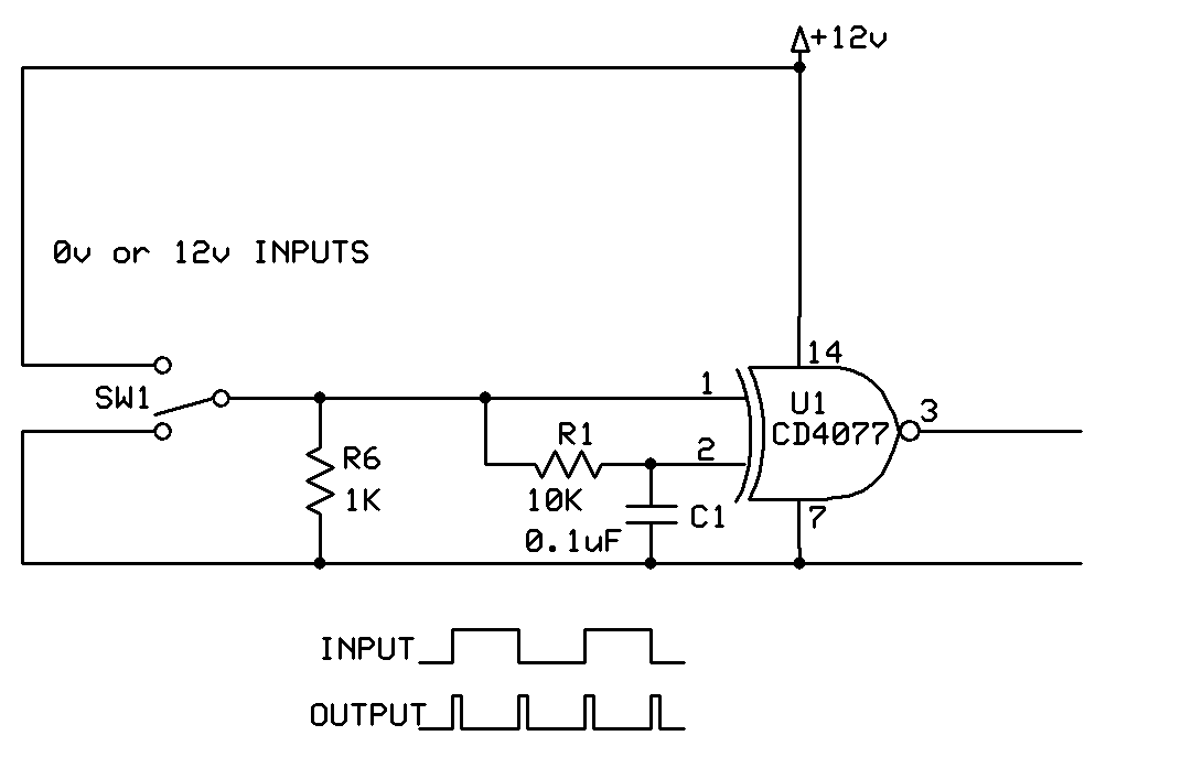

I'm not sure about the 240VAC or 40Vdc part, but the CMOS part is an "edge detector".
Ken

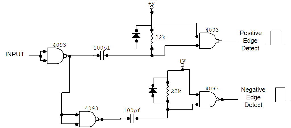

Attached is a CMOS logic version. The input level is for 4000 series logic, so naturally, your input voltage levels will have to attenuated accordingly. One output provides a positive pulse when a positive edge is detected, and the other output provides a positive pulse when a negative edge is detected. The gates are schmitt trigger types.

That circuit will not differentiate between rising and falling edges, which he requested.
hi Carl,
Ken's 4077 circuit works OK for giving an output pulse on rise/falling edges and is commonly used in encoder circuits.
The pulse width is set by the 10K/100nF, the pulse Tcr period, needs to be less than the driving pulse width
I misinterpreted their: "I want it to differentiate rising and falling" as differentiating as in an RC network. :(
ken
