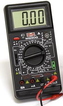

I own a very basic 'Mastech' DMM and was not anything more than 6USD when converted. But eventually I'd like to replace it :)
