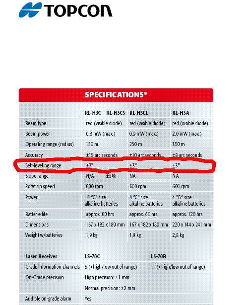

I need an idea or directly any circuit which the circuit can automatically self level it position in X and Y direction..
I have a laser transmitter which i must calibrate it to ground level such that the beam must go and hit the reciever with out any deviation..

i have given round mark for that..
Do you mean the 'platform' has to be horizontal to the earths surface and remain that way even though the 'platforms' supports are moved.?
Yeah, u got my point ERIC,
The plaatform must be horizental referenced to ground level if its moved my natural calamities and it must adjust to that automatically buddy.
Do u have any suggestions for that.?

If the scanning laser is using a prism or mirror to deflect the transmitted beam from the vertical to the horizontal, then the standard way is to change the tilt of the prism/mirror rather than change the tilt of the complete laser head.
The prism/mirror having a small mass enables it to positioned by a small motor that controlled by a tilt sensor drive.
EDIT: note the amount you can level this way is +/- 3deg, refer your specifications.

The design of a automatic laser levelling system is quite complex and IMHO far to difficult to realise by using a forum.
These are some links showing some of the level sensor types available.
This first one is interesting, he has taken out sensors from a hand held wii controller.
YouTube - Arduino rover v3.1 - auto levelling sensor platform
