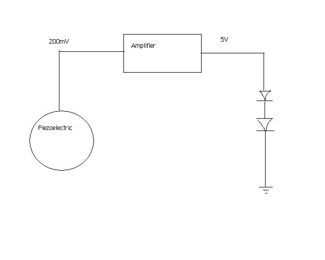

Hello,
I have been plagued for the last couple of days on how I would be able to amplify the voltage from an Piezoelectric buzzer or an electric drum pad so that when it is struck an array of LED's will light up.
I tried op-amps (but not sure If I had it set up right), transistors, and an audio amplifier but neither seem to work...I feel as if I built and rebuilt every circuit you can build to do this.
I don't know if I'm missing something with these circuits of just am building the wrong kind
Please if anyone can help me with a schematic that will take the input signal voltage with a peak between 200mV to 1.7V and amplify it to a voltage that would be able to drive an array of 4 LED's (Shown Below) I would be extremely grateful.
Or if not just a direction as to what IC I can use such as an op-amp or audio amp that would do the thing I want.

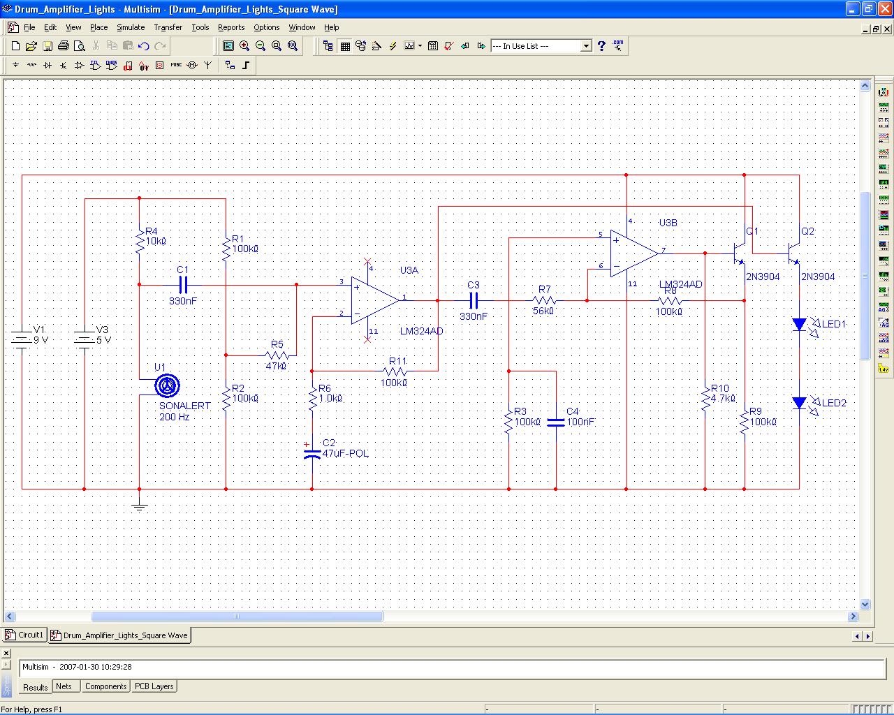

Heres the only circuit schematic that seemed to work for me to where when I hit the drum pad the lights do light up. However it seems like there is a simpler circuit out there that would do the same...
I took this one (Pic1 which is what I'm trying to go for) from audioguru's sound intensity indicator circuit but It seems to only work when I take it from the output of the first stage where the gain is about 101. I would like to take it from the second stage so I can put a filter on it and turn it into a square wave but whenever I try to do that after the first stage it messes up the rest of the circuit and the lights don't work anymore.
Some simpler ones I built but don't work are shown after the circuit below (where the electret microphone will be replaced with the drum pad.
Please if anyone knows how I can simplify the circuit so that there is one stage of an op-amp I would greatly value your help.

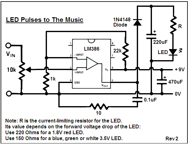

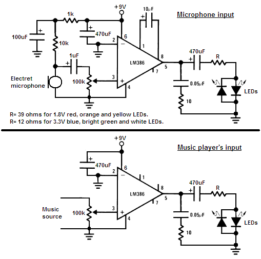

My previous circuits respond to long music notes. It would light an LED only very briefly when a drum pad is hit and the LED won't be seen.
Here is another circuit that lights an LED but it has a capacitor to stretch the pulse long enough for you to see it. It would show a drum beat very well. Replace the pot with a biased electret microphone and add a capacitor between pin 1 and pin 8 to boost the gain if you want.
A piezo transducer might need its polarity turned around to work better. Remove the volume control pot when a piezo transducer is used.
A lighter has a piezo that is hit with a small hammer and it makes a few thousand volts. I hope your transducer doesn't break the input of the LM386.
Wow thank you Audioguru...Once again you saved my ass. I haven't built it yet but I plan on doing that later today. Thanks again and I hope it works.

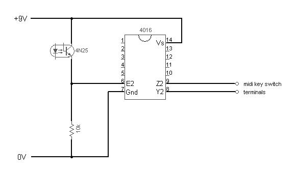

hey i'm not sure what you're using the electric pads for, but i've been messing around with a custom midi interface a bit, and to trigger midi notes, i've just been lazy and hacked into a small old midi keyboard (evolution mk-125)...
but i'm assuming you could do it with any midi keyboard.. if you find the switch terminals under the keys, and connect those to a 4016 bilateral switch, you can then trigger the notes with pretty much any circuit..
so if you replace/put in line with that LED in audioguru's circuit with a 4n25 optoisolator, and then use that to close the switch on the 4016, you could trigger midi notes with your drum pads.. :D
this is just the basic idea though, probably need to filter out glitch notes...if you're interested let me know
