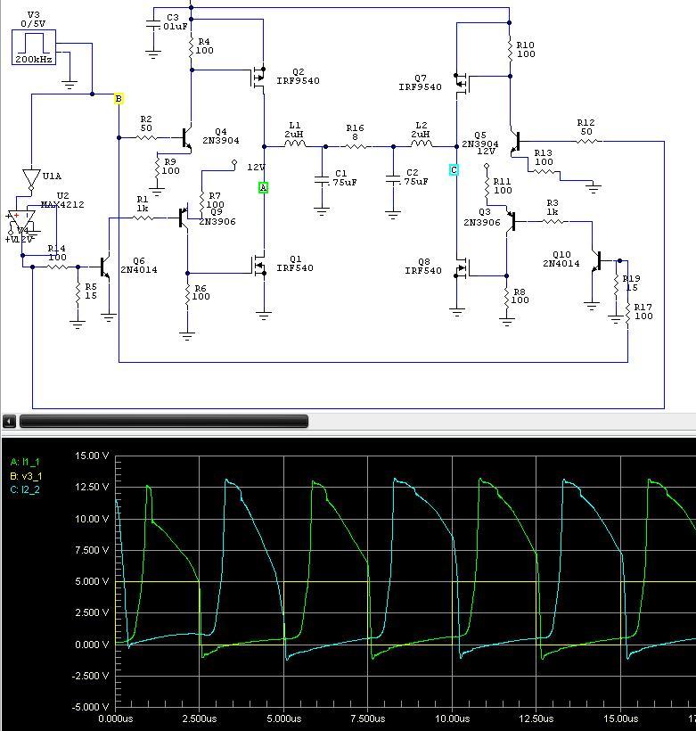

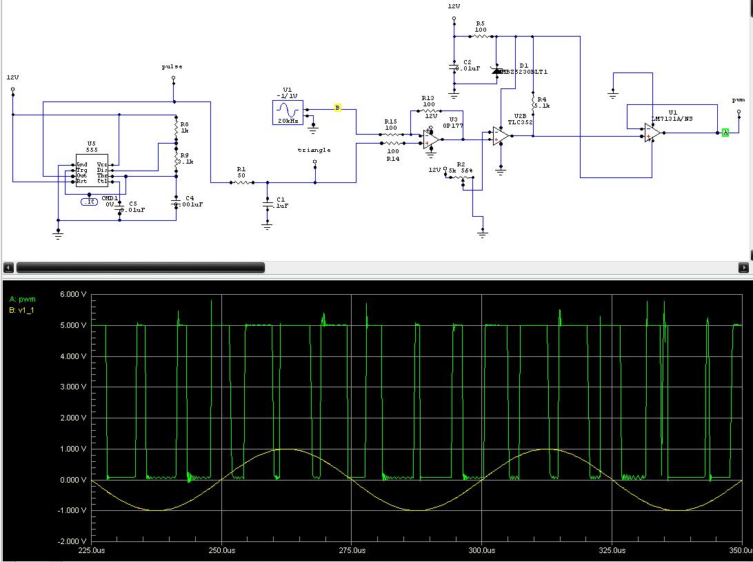

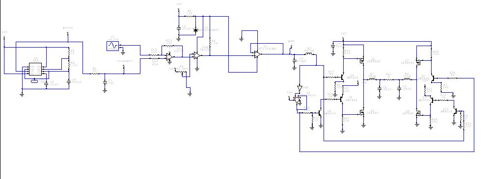

Hello, I'm building a class D amplifier for my school project and I need a lot of help because I'm so lost. The amp uses 12Vdc as its input, the frequency range I'm trying to get is 20Hz to 20kHz, the speaker is 4 ohms, and I'm trying to get as much power possible without the use of a DC-to-DC converter. I've been using CircuitMaker2000 to simulate my circuit. Please tell me what I'm doing wrong, since my H bridge does not work at all. Thanks.

Here are a few points.
U3, the OP177, doesn't seem to have a power supply.
R18 and R19 seem far too low because they will make Q6 and Q10 too difficult to turn on.
Q5 is the wrong way up.
R7 and R15 are pointless, as 10 k:eek:hm: in parallel with 50 :eek:hm: does nothing.
The simulator should tell you what waveforms you are getting. Check the waveforms at various points through the circuit to see where it is going wrong.
You need to run the PWM at a much higher frequency than the bandwidth of your system, I would try to go up to 200kHz if you can but you might be able to get away with 100kHz. This can make the design of the switching circuit very challanging as getting MOSFETs to switch that fast whilst minimising losses isn't easy. Then there's building a good output filter that happilly passes the audio band but rejects all the RF.

You don't have to reject all the RF, just make it small enough - class D amps commonly have a switching residue on the output. Assuming the values in his example above were correct, then that degree of filtering is probably fine.
But as you say, the higher the switching frequency, the easier the filtering is.

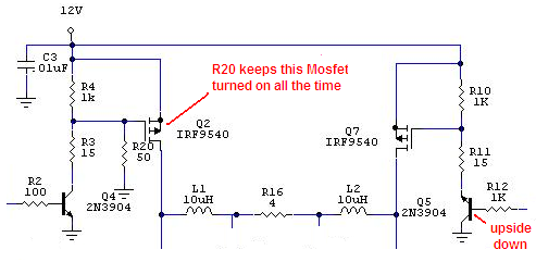

I made notes on the schematic:

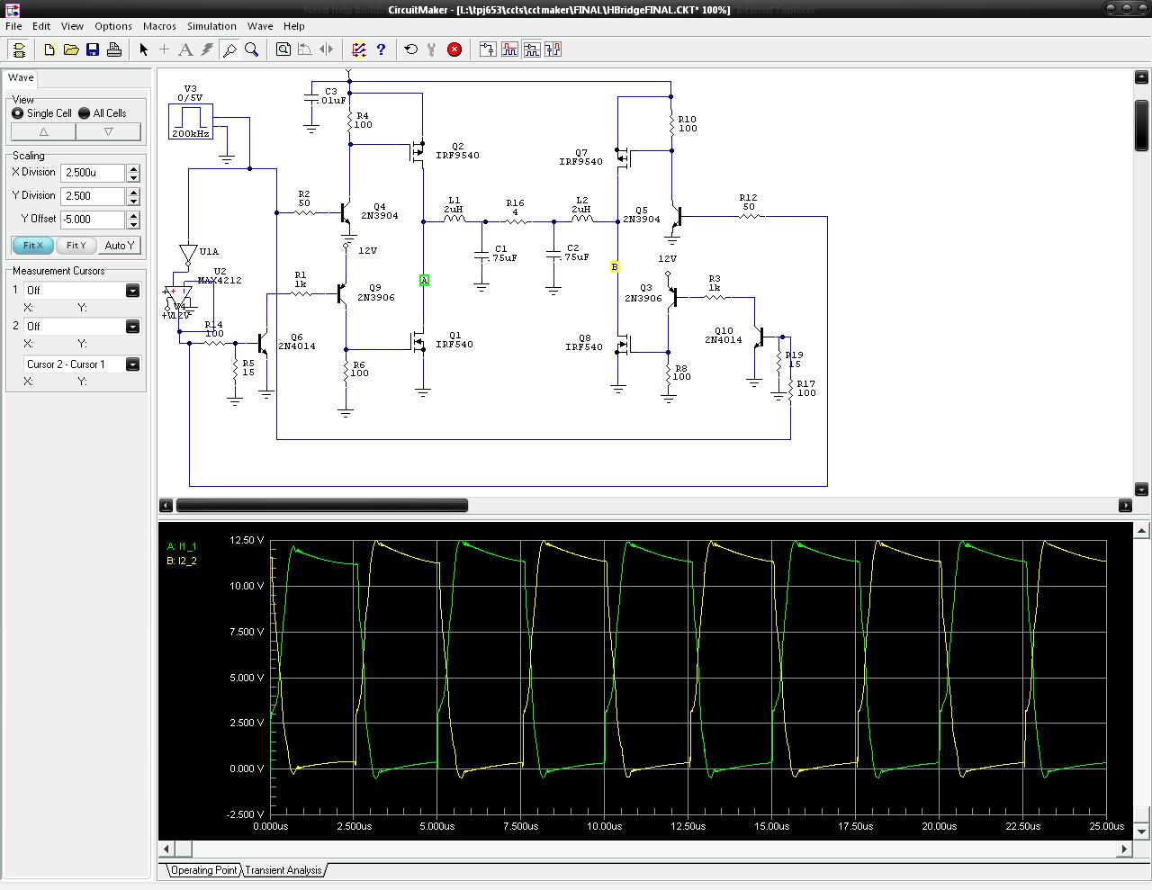

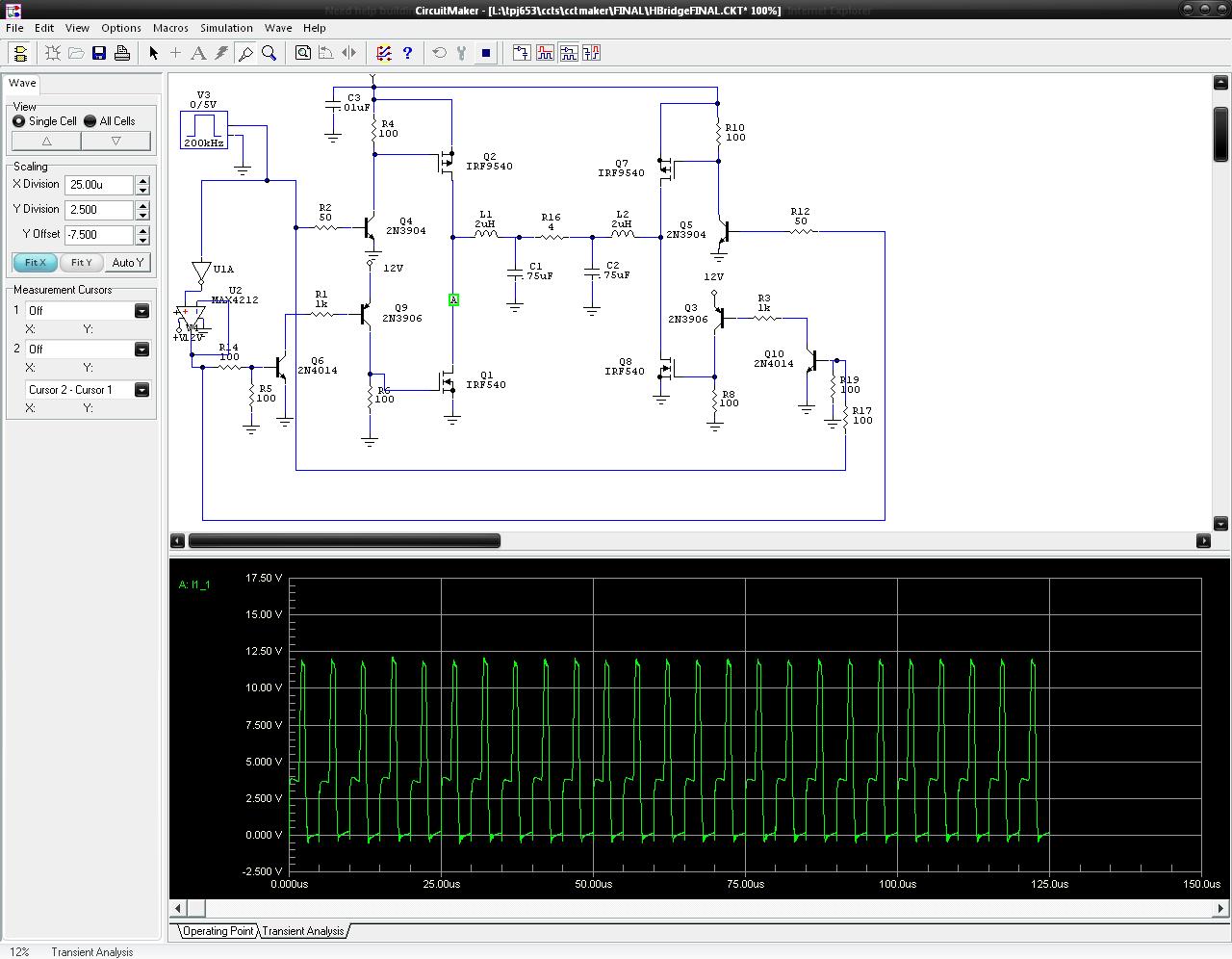

Hey, I changed a few things around according to the replies. I tried to make R5 and R8 bigger values, but I got a really weird signal, see Hbridge2 attachment. When I left R8 and R5 alone, I get a much better signal, but there is some crossover. I was wondering, what is the best way to remove crossover? Can the totem pole transistor configuration work? Thanks

The 2N3906 PNP transistors don't have a resistor to turn them off quickly. So they slowly float off then they turn off too late.

Doesn't matter, it's a PWM switching design, crossover distortion doesn't apply as the transistors aren't used in a linear fashion.

The transistors are switching ON and OFF at a fairly high frequency, and the width of the pulses is controlled by the audio input, and the audio recovered afterwards with an LC filter. It's actually two amplifers bridged together, this effectively gives twice the supply voltage, and four times the output power into the same impedance.
For higher power use in cars you would use an inverter to increase the supply voltage, otherwise single ended is 4W maximum and bridged 16W maximum (both into 4 ohms).
Hey, where should I put the resistor to make the 2N3906 transistors turn off quickly?? Sorry, I'm kind of slow on this stuff. Thanks

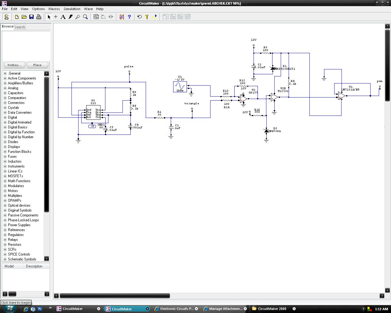

Hello, I was wondering, what is the best way to impedance match because when I combine my PWM circuit with my H bridge circuit, the simulations won't run at all. Thanks.
