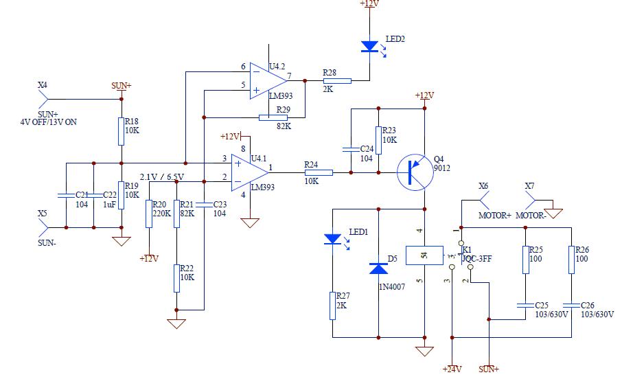

This circuit determines which voltage supply to switch to the motor - solar panel (SUN+) or power supply (24V+). My comparator circuit is toggling on/off when the +V IN is near the -V IN (6.5V). It cycles very fast.
Can anyone give advice on preventing the toggle? Circuit is attached.
Thanks in advance

Looks to me like there's no feedback around the controlling comparator... U4.1, but I could be wrong..

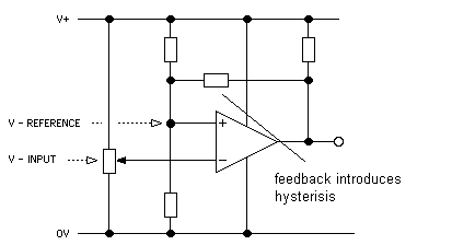

See the attached sketch

I can't claim the design. It is a prototype product for me. I tried a few feedback options but I don't know enough to select the right components or put them in the right place.

Usually adding a resistor between pins 1 and 3 of the comparator will add hysteresis.
Start with a high value, say 470K,, the lower the value the greater the 'dead band'.
EDIT: if you do add hysteresis you may have to readjust the SUN on/off points!!

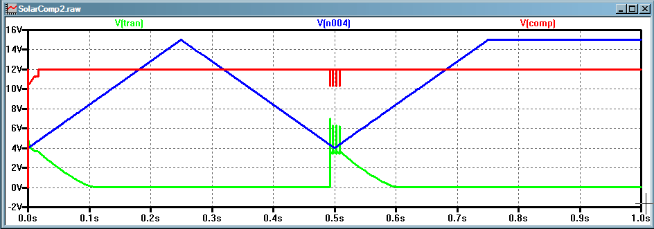

hi 1ab,
This are the results from a LTspice simulation.
The results dont agree with what you say on the circuit diagram.???
Check thru this LTS circuit, the caps have been omitted for clarity.
What colour is the LED 'D2' on my circuit.???

hi 1ab,

The placement of C23 is part of the problem because it prevents the
snap action of the hysteresis from working properly. The design should
be changed to eliminate this cap or to modify the hysteresis feedback.
One way might be to place the hysteresis resistor (of the right value)
between pins 1 and 3 and let the LED section go without any hysteresis.
This way the cap C23 can be left there for a little filtering.
You also need to add some resistance between pin 3 and the two
caps connected to that pin so the hysteresis works properly.

The point I noted was the switching points, the sim makes these 4V and 10V.!
The voltages marked on the circuit marked at point Vr dont agree with the sim.
EDIT:
I'll re-run sims with C4, also introduce the offload jump OK, let you know the result.
BTW: making D2 a green LED, changes the limits to 4V and 11V

The range is +4V and +10V according to the LTS sim,
MrAI, Are you talking about moving R29 to U4.1 pins 1 and 3 then adding R31 between pin 3 and C21 / C22? What value is needed for R31?
FYI - the circuit reacts very differently on the solar panel than on a power supply simulating the panel by restricting the current. The cycling is very fast when on the panel partially covered.

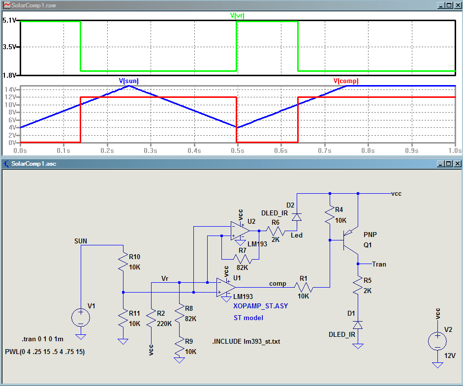

hi 1ab,
With the high jump in SUN voltage when going off load, the circuit is definitely unstable when running in simulation.!
I'll see if I can suggest any changes,, it will be tomorrow OK.:)

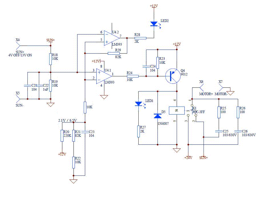

Before i could draw up a circuit, i would need to know what the turn on and
turn off points need to be.
Here is a circuit with a quick fix, although the value of the lower resistor
for the voltage divider would have to be adjusted to make up for the
added 10K resistor (which aids the hysteresis).
hi Al,
The problem is when the comparator/relay switches the motor load from solar 'SUN' voltage to the 24V external supply, [at the low SUN limit of 4V], the offload voltage of the solar panel jumps up to about 17V.
This 17V jump causes the comp to switch the relay back to the SUN voltage source, as it exceeds the high limit voltage of 14V, which as soon as it goes on onload drops to about 4V! again.
Basically the circuit design is unstable.
I have run a number of sims in LTspice which highlight the problem.
Regards
Hello there,
Ok, i was assuming all the simple ground work had already been done
and based my assumption partly on your simulation, which shows the
problem with that cap. Note that whatever system is used, if that
circuit is to be used for anything some mods need to be done.
All i can suggest at this point is that the OP post the entire setup
the way it is wired to all the devices in the system. This way we can
make a better assessment of the situation and recommend a good
circuit to achieve the desired goals.
Overall it was an interesting circuit in itself, but i just feel that
another approach altogether would be a good idea anyway.
Here's the sim i based my circuit on:

hi Al,
I agree, the circuit needs to be reworked, based on the complete project.
