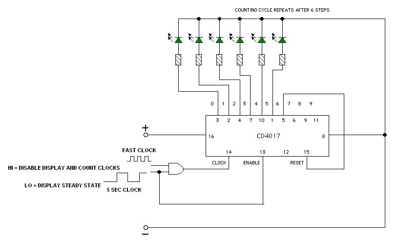

I am setting up a hockey shooting station in my basement. i have a goal with a wall mounted radar gun. i am looking to use 6 d/c lights at the six positions of the net. i want the lights to come on in a random order, one at a time, light stays on for 5 seconds, then shuts off for 5 seconds and another random light will come on for 5 seconds then shut off. i want this sequence to continue for 3 minutes. i would like it to be push button start. could this be done for a reasonable amount of money. is there already a device out there i could use to do this? thanks for any help
A 4017 could be setup to count to 6 with a very rapid clock that is gated with a second 3 second timer. Both timers could be 555 chips. Search the web for 4017 and 555 circuits or, someone here with some spare time may knock up a schematic for you.
The effect will be slightly different as all lights will be on (but dull) for 3 seconds and then 1 will stay on and be brighter. A slightly more complex circuit could extinguish the lights during the off time.

ok, it finally sank in what Pommie was talking about in post #2... something like this:
If you use cheap leaky electrolytics for both clock generators you'll probably get better randomness.

If you choose the fast clock rate appropriately and give the slow clock a mark-space ratio of, say, 95% you can use the 5% period (a) to blank the lights to prevent flicker and (b) to gate the fast clock pulses to drive a CD4020 or similar counter and so define the required 3-minute period too.
The mark to space is 50% (5 seconds on and 5 seconds off).
