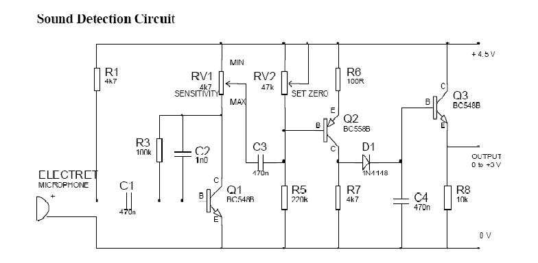

thanks for the circuti....
i've found one of sound circuit but i need some suggestion of this circuit...
can i connect the output to the microcontroller?? any suggestion??
thanks for the info,
but may i know what's schmmit and how to raise the voltage?
can show how to connect in circuit?? thanks
