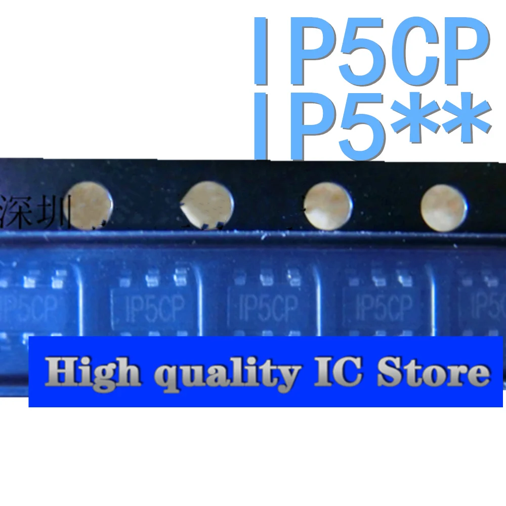

I can't find any cross reference to the IP5xx part marking, but that is not unusual for surface mount part codes.
Aliexpress have some IP5 six pin ICs listed, but there is no way of knowing for certain that they are the same part. The part numbers listed against them come up as an eight pin device or a six pin LED driver...
(The last two digits are probably coding for the manufacturing date or site, so vary batch to batch.)
Thank you for your answer. That look very good. I contact with my friend and he told me that it's buck converter or led driver. But in my previous post I added link and screenshot where the element is with one different digit and say buck converter and I am confused.
OK, if it's the LED driver, the aliexpress ref may be correct and it's an MP2370 or clone of that?
