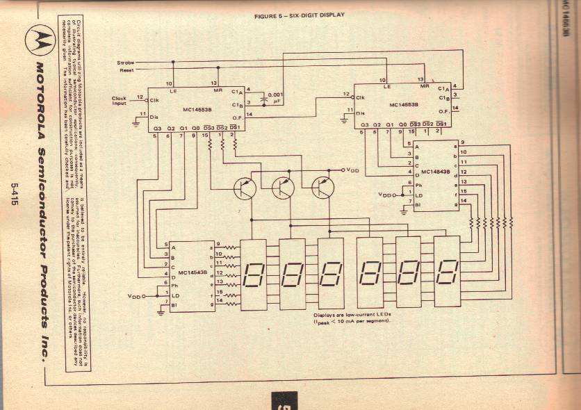

the holy grail.....? digital scoreboard schematic
I have decided to join the long list of people of various electronics forums who want to build a scoreboard. :)
I play volleyball so looking for set (to 5) and score (probably 35 max) ideally with some reset function (6 digits 1, 2, 2, 1) the set (1's) can be a seperate system but i am confused as to how, if i set up the 2 digits, as to how they increment beyond 9.
The inputs will be a manual trigger (button), components without microcontroller
I have alot of information floating around but it would be really helpful to find one source of information to help build this. I have checked out Aaron Cake's site and this looks like a good starting place, although raises a few questions with regards to pulse etc. I am trying to create the board for an electronics project.
I'm happy to document the production (thus ending the quest for this much sought after project).
Any information would be much appreciated. work commences tomorrow and I will create a new forum on this topic. Watch this space!! (please help!! :))
