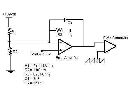

Hi all,
I am trying to design and test a type II compensator for a synchronous boost converter. I obtained the control-to-output transfer function (credits to "Fundamentals of Power Electronics by R W Erickson") for the ideal case. The circuit parameters are:
Vin = 42V
Vout = 189V (approx 77% duty)
L = 1mH
C = 1000uF
Load = 4170VA
The PWM controller is the UC3823n with Vm = 1.8V (peak to peak).
In order to eliminate the effect of the Right Hand plane zero and in order to move the cross-over frequency further, I designed a type 2 compensator (please see attached diagram) for a 5% overshoot and a < 0.1s settling time (on MATLAB).
The thing is IT DOESN'T WORK. Either the output is 44V or just erratic.
As I am not yet at under any serious load condition (large output impedance), could this be the cause of the poor operation of the control system? I replaced the UC3823n with a simple function generator and the boost gave 192Vdc with 77% duty (means my power-electronics setup is ok).
Can anyone suggest values for R3,C1,C2 for the compensator (as per the attached diagram)?

You compensator is an integrator; there is no DC feedback around the opamp. It looks to me that you are building a PID feedback controller with only the I (integral) term. Seems like every time I tried to do this, I built an oscillator; not a damped output control system.
Seems like you need a P (proportional) term too.
Without doing the sums myself, the compesation you done looks 'about right' to me.
Only goes screwy closed loop?
Not something silly like the real X-over frequency too high (more than 5 kHz) is it? Maybe grounding or something?
You could try grossly over-compensating to get it stable in closed-loop, then work backwards?
That is in deed a type II compensation circuit.
Any reason you can't go to current mode control, eliminate the Right Half Plane Zero and use type I single pole compensation (simple integrator)? How exactly are you controling the synchronous "rectifier"?

The partial schematic you showed has the output of the "compensator" going to a PWM. If you were building a true PI controller, the P term would be summed with the I term BEFORE going to the PWM. I still see only an integral term.

A Type II controller has just integral and differential terms and no proportional (DC) feedback. It will be stable with the proper compensation values. Leaving out the proportional term has the advantage of no DC steady-state error in the output voltage.

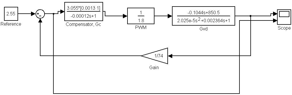

darkfeffy, did you do a small-signal, closed loop simulation of the system with a gain block simulating the PWM generator? I performed such a simulation for a Buck switching regulator I designed to optimize the feedback elements (which indicated some adjustment was needed from the calculated values for best stability), and the built circuit operated very close to the simulations. Can you post a block diagram of your simulation with the block transfer functions?

Ok, but I just went and looked at the OP's diagram again, and there is only a I term; nothing else...
The diagram at the beginning of this thread shows a capacitor (integrator) feedback and RC (rate or differentiator) feedback, two terms.

Your comp network has a zero at 128 Hz and a pole at 1,594 Hz. You have a low bandwidth for your servo loop. Your rhpz is at 1,516 Hz, less than your highest pole. This is unstable. The 0 dB crossing point should be 30% to 40% of the rhpz frequency.
Crutshow, here is the block diagram. Curiously enough, MATLAB has "difficulties" simulating (*step response*) when you put the compensator pole very close to the RHP zero (of the control-to-output tf).

I believe the gain of you PWM block is much too low. If 77% duty-cycle gives 192V then 100% duty-cycle would give 250V. The PWM gain should thus be 250/1.8, not 1/1.8. That extra loop gain could be causing your instability. Try recalculating the compensation values and resimulating with the higher PWM gain.
