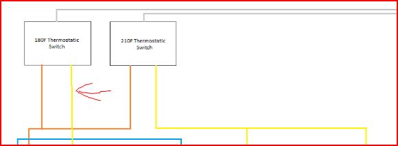

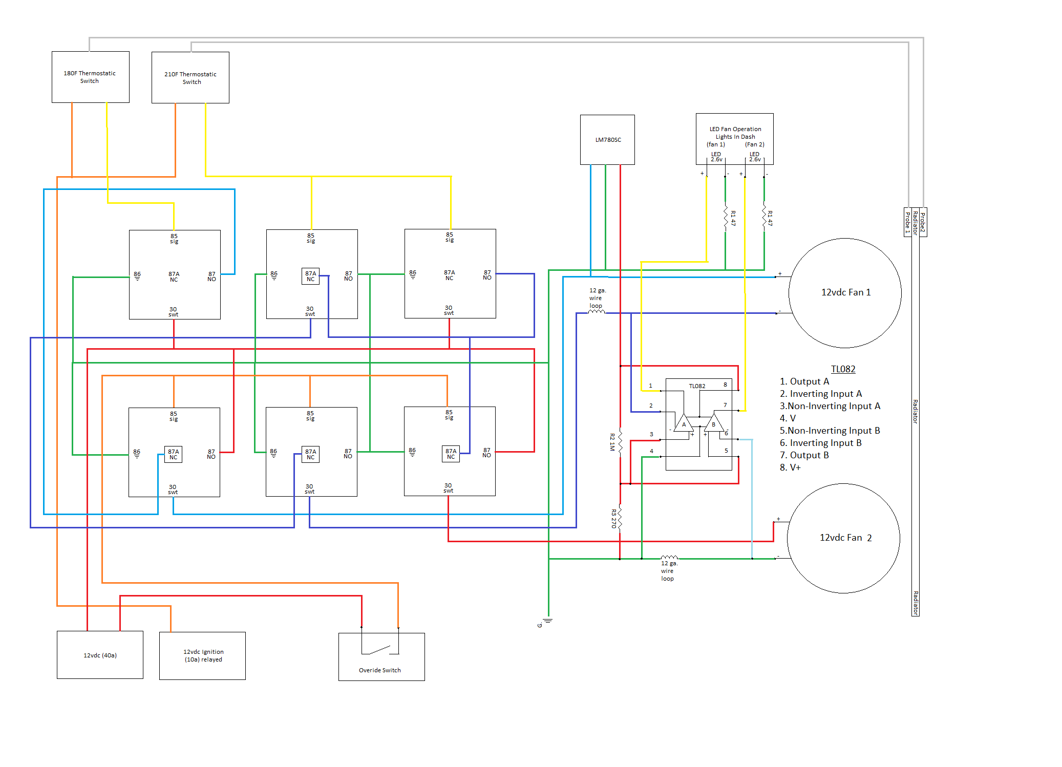

So I got it wired I attached a one line so you guys can see if i got this right. Still have to go install it, going to bench test first before I start screwing into my engine bay (waterproof enclosure)

Looks good, Trent.
Don't forget the various capacitors that Ron suggested:

Ok got this thing wired and bench tested it. I have LED's on when the fans are not running/not powered. When i turn the fan on I get a 36amp inrush and a running DC amperage of 9a. While running i get 25.6mv between the fan negative thru the coil to ground. The LED still is on even with the fan running. Do i need a bigger resistor? The only thing I wired different from my one line is on the negative from BOTH LED's to ground I only used one resistor. So they don't have there own resistor to ground. While bench testing I only turned on Fan 1 full speed Fan 2 wasn't wired. Would that be the cause of that or am I missing something else?

The 12ga coil of SOLID copper is about 1.5 feet long and it was folded in half twice and ran to there corresponding locations on the one line i drew. Its not an actual "coil" but still produces 25.6mv. Don't know if that is an issue or not
With power applied to the comparator circuit, but both fans OFF, what is the bias voltage on the non-inverting (+) inputs of the comparators (should be about 7mV)?
Then check for those voltages with one or both fans ON.
We might need to add a 100 ohm resistor to the inverting (-) leg of each comparator to bias it to ground when the fan(s) are OFF. Sometimes "floating" inputs cause erratic behavior.
fans off 3.1mv from non-inverting (+) to ground. I was getting nothing from all other test points. With a fan on testing non-inverting to ground i got 3.4mv

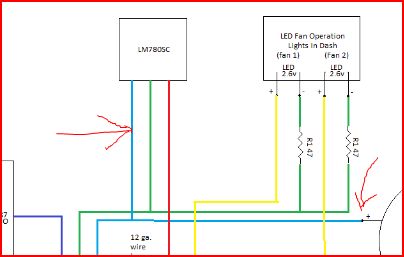

Is the 7805 being powered as you had shown in this schematic? (I missed this in a previous post):
If so, it needs to be powered from this line
