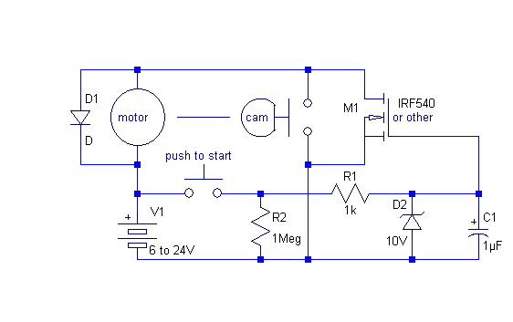

So anyway are the diodes necessary in that circuit? Right now I am running it without them. I do need something to keep the motor running for 2 to 3 seconds after the switch is pushed until the cam pushes the micro switch in for the rest of the revolution. I might be able to build the flat on the cam up a little bit but I would still need to do it for about a second. Any suggestions?
This should hold the motor on for a couple of seconds or so. You can change the amount of time by changing C1 and/or R2. The diode will protect the MOSFET from voltage spikes generated by the motor.

There is nothing wrong with Ron's circuit.
There is nothing wrong with Ron's circuit........

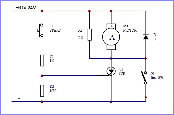

This is offered for discussion only, based on the idea by Zevon8. Resistor Rx is there to provide the minimum holding current to the SCR to prevent commutation of the motor turning off the SCR.
Ron's circuit uses the limit switch NO contact while this circuit uses the NC contact.
The subtle difference is that Ron's circuit will stop the motor when the flat on the CAM comes up to the limit switch while this circuit would stop the motor when the switch reaches the end of the flat.
Nice work on the SCR design. Rx would likely be neccessary in most cases, good catch.

Elegant solution, LC. :)
