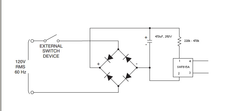

The 4 diodes would be in this package.
https://www.circuitspecialists.com/df06.html
There are 4 pins: 2 of them are for AC in. The other 2 are the DC output (+-)
The switched side of the footswitch would go to one of the AC inputs of the little gizmo. The other AC input would go to the neutral.
A Capacitor on the DC side will filter out the line frequency (Just like in a power supply).
You would use this IC.
https://www.vishay.com/optocouplers/list/product-83433/tab/specifications/
Here's a schematic.
Be very careful around the bridge rectifier! It's 120VDC, and can kill you.

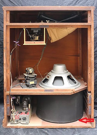

I would place a small IR sensor where the red arrow is ( google HOA 1405-2 ) and paint 10 white dots spaced equally on the bottom edge of the sub-woofer. The RPM range of the subwoofer, from memory is about 50 - 500 RPM; It would be very easy to tell a small Arduino to turn on a Red LED at 70 rpm and at 400 rpm a Green one. You could even use an LED Bar Graph and have 10 gradual indications. The only power issue you would have is providing 9 -12vdc for the Arduino - could even be done with a battery, although it may not last too long. I would site the LED's on the console, but you could use the Arduino to turn on/off strips of LED's in the pedal area via a suitable transistor.
I know the Arduino code may be a concern, but there are loads of examples on the net and plenty of folk in here to help you get it as you'd want it.

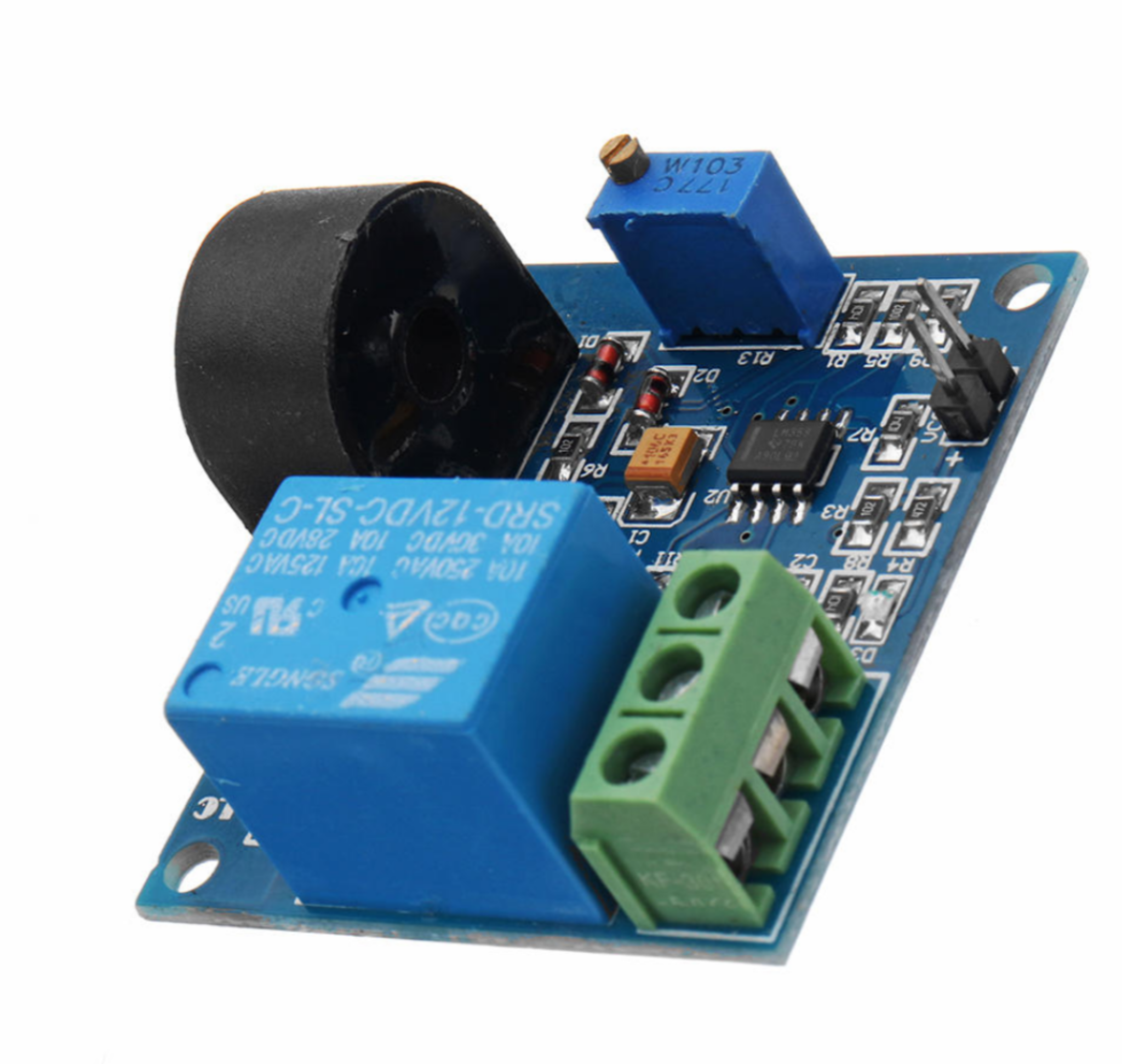

JeffGee: That particular module is designed to sense an overload. It looks like it needs to have its' power recycled when it senses AC current above a certain value.

Since you'd have to cut the wire anyway, you might as well use one of these. This module will sense the presence of AC voltage, and produce
a sine wave at a much lower amplitude. (0-Vcc, with Vcc / 2 being the half-way point. It goes in series with the switch wire.
