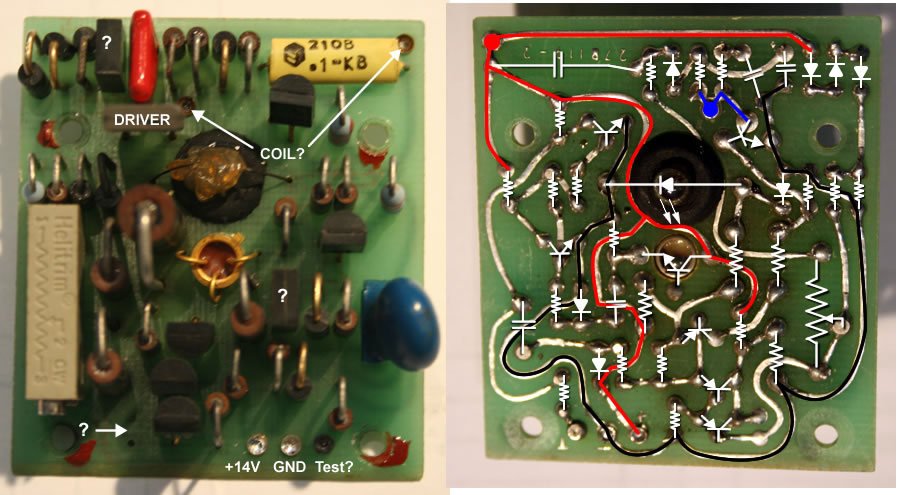

See if I got these diodes right, and if those components with the "?" are caps or not.
If that little board is driving that coil, it looks like it's an NPN collector drive, and I don't see anything in the circuit to reverse the polarity.

I am curious about the metal can transistor in the center of the small board.
It would be interesting to confirm if is PNP or NPN .... it has hole cut in the board for its top ....
What, the phototransistor? It's NPN - look at the emitter tab and the voltage connection.
There's an LED and a phototransistor on there to detect the black part of the flywheel, apparently. OP said another style used an incandescent lamp, and the schematic was from one that looked like it used a switch.

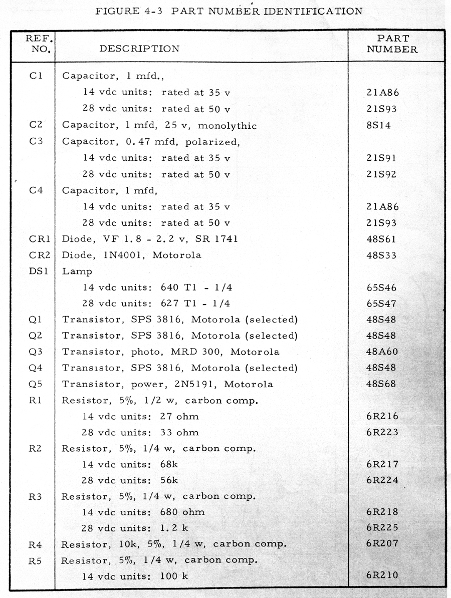

The little board does indeed drive the gyro and there were at least four versions of the Gyro CB. Each was declared obsolete and unavailable when the new version was released. Because the rest of the circuit remained unchanged, a new schematic was never published. When a Gyro CB failed it was simply replaced with the current version of the board. Nobody ever repaired them (it was usually the little light bulb) ; the boards were simply replaced. This was much better for cash flow unless you were the guy paying the bill.)
The board I'm using (the green one) looks to be version 3. The older gray colored board is version 2. The little schematic in my original post... (Hats off to Larry!!! And a great job on the schematic) ... is version 1 which did use a switch.

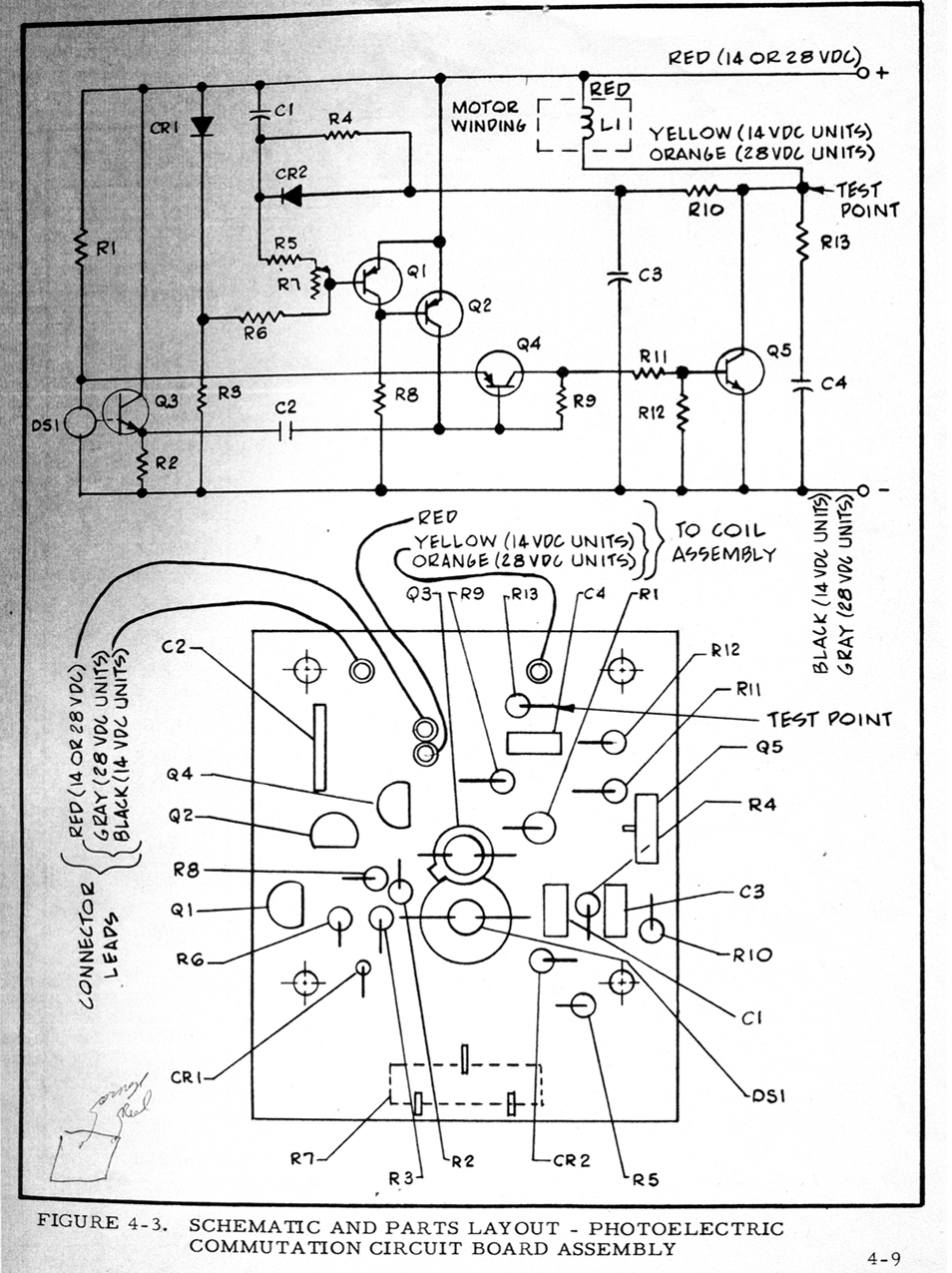

We can forget the L-1 / L-2 problem and the 2 wire / 3 wire coil dilemma. I now have in hand (and attached to this post), a parts list and component layout illustration... (hats off to 88! A great suggestion that really paid off) ... which includes a schematic of version 4! Version 4 looks, to my untrained eye, to be almost identical to version 3; save for where the power leads connect to the board and a slightly different configuration of components. I haven't yet checked the indivdual component count and markings but will do so in short order.
My confidence level and the odds of success have skyrocketed!!! The gyro's still only spinning a half a turn at a time but with this new info and a bit more help I'm sure we'll get this running again. My green's board did originally have a burned out light bulb. So a while back, after applied power to the board, I measured the voltage across the bulb's leads. It was 6V. So bulb in hand I went down to radio shack and got a similarly shaped 6V mini lamp. The parts list (which is almost complete) calls for a 14V - 640 T1 - 1/4" lamp. So my first question is what effect could the 6V vs 14V bulb have on the circuit? Too much or too little light? Too little or too much resistance in the circuit?

Another question, the gyro (coil) that the little green CB came from, had overheated so badly that the interior of the gyro housing had puffed up and expanded to the point of fully encapsulating the rotor and gimble; locking them both in place. Is there a single component failure on the new schematic that would have likely caused this much overheating?
The drive transistor. They tend to fail short, and the coil's only intended for intermittant duty.

Check my post on the previous page - I have the drive transistor marked "driver". Not the phototransistor, they can handle very little current.
The new schematic is closer, still not the same - count the transistors.
I don't see any reversing going on, but there's a pulse generator that's triggered by that Darlington (Q1 and Q2).
The adjustable resistor controls the width of pulses going to the motor, looks more like a start circuit than a speed control. That's a 10 or 20 turn pot, by the way.

I looked at your tracing and labeling on the double board photo. The "driver" you labeled is marked M226 43A68. Close to some of the p/n on the new listing.
I count 6 transistors on the green board and only 5 on the drawing.
How sensitive are the photo transistors? Might the wrong lamp (6V vs. 14V)effect its operation?
Start Circuit? Can you expound on that relative to the new schematic?. I've had the feeling I'm stuck in some sort of start phase. Maybe a few turns back and forth might bring that pot back?
How about C-1, C-2, C-3, and C-4 in the new drawing... Does current ever flow thru them? Intermittent bursts maybe? Or do they just smooth out ripples in whatever they're parallel to?
EDIT: I found a datasheet on the photo transistor MRD 300 and will spend some time trying how to interpret it.
EDIT And can you explain the Darlington Q-1, Q-2 circuit or branch?
AND what would be the "driver" in the new schematic? Q-5?

When Q5 turns off, sharply, the flow of current through L1 and Q5 is interrupted and you get a sort of 'water hammer' effect, except with electric current rather than water.
The resulting voltage pulse travels through R10, CR2, R5, and R7 to turn on Q1, and reverse the current flow, which goes through Q1. .... Can you get the value of R8?
...either from the board or page 2 of the parts list. .... Also, it looks like some of the reverse current pulse goes through CR1 and R3 .... It's not really an efficient design, but apparently they got it to work.
You probably need to adjust the R7 pot. so that Q1 turns on just as Q5 turns off.
It ought to work if you can adjust R7 ... When you turn the R7 screw, take note of how many turns or quarter turns one way, and then the other that you adjust ... so you can go back to the original position if necessary.
Duffy says that Q1 and Q2 are a Darlington pair, but I'm not so sure. If Q1 turns on, then Q2 would tend to turn off. ... And Q2 current goes to a different place than Q1 current.
I would replace the 6V bulb with a 12V DC version.... probably last longer.
Also, maybe replace Q5, the power transistor. If there is evidence of heat damage, it may be defective. ... I would check it with a transistor testor ....They used to be easy to find ... not too expensive.
I don't see any speed control ... just that Q1 threshold using R7.
The new circuit and layout are not exactly the same .... but maybe close enough.
I can answer some of this now... but what do you mean "see if I got those diodes right? Do you mean properly identified as opposed to being misidentified as resistors? Polarity (direction)?
Your Question Marks:
? Bottom left... Transistor: marked M224 48S48, same as the one just above it; another 48S48. The top transistor in this row of three is marked: M224 48S64. The 2 transistors at center and top right are marked: M224 48S69 and again the transistor you marked "driver" is marked: M226 43A68.
Many of these cross or close to the new parts list. I'm thinking the 4 digit markings are p/n and not industry standard spec numbers. The M224 and M226 might be case styles? Is this correct?
? Center Right... Unknown: marked 1u with a big K below that. It could be a 1uF cap?
? Upper Left... Unknown marked: T318. The red cap to the right is marked 1mfd 25V monolythic.
Coil connects? Correct as labeled
Power connects? Correct as labeled
Does this mean your red and black tracings on the bottom of the board should be reversed for red power/black ground?
Test? Probably. Nothing connected there and there is a test connect marked on the new schematic.
