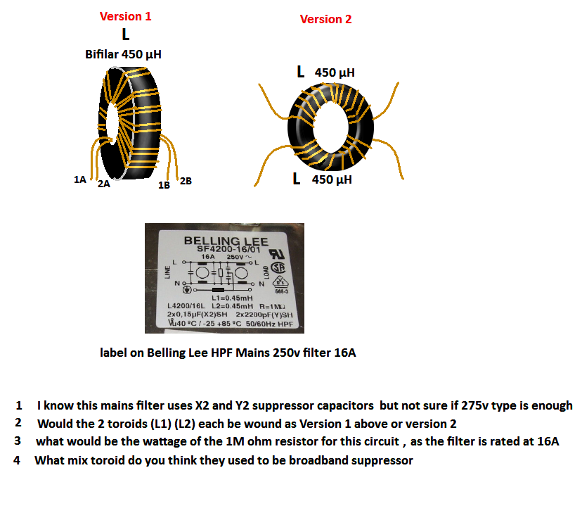

Hi.
I cant seem to source any Belling Lee 250v mains filters anywhere, so have been thinking of constructing one.
The things I am unsure of are detailed in the attached picture of a belling lee diagram label
. Could some one please take a look
and help me out.
Thank you.
I am surprised that you cannot find a filter to buy.
What are the important parameters for your application? Voltage, Current, Attenuation ?
If you were to build your own, I think that 275v X and Y capacitors should be OK.
The 1 meg resistor will not dissipate much power, it just needs to have a rating of 250v or greater.
It is just there to ensure that the capacitors do not hold a residual charge when disconnected from the mains.
The inductors, not too sure about them.
I think that the mix will be a lossy high Al (mu ?) ferrite.
As for the windings, there may actually be too different forms in the complete filter.
One to to suppress common mode noise, and one to suppress series mode noise.
Coilcraft.com CMT1-.6-15L or CMT2-.5-15L
The capacitors need to be "X" and "Y" caps! Kemet, TDK, Panasonic..
It can't be that critical so I have to ask does the filter have to be identical?
I know the Belling Lee is now no longer made but Farnell offer this alternative.
Well it will require you to redo the noise tests for UL and CSA ets.
Assuming that this filter is going into a commercial product for sale in the USA.
I have a sneaking feeling that it is for a private project in the UK, so UL and CSA are not relevant.

You need a resistor that is rated for the peak voltage.
You can use two lower voltage resistors. (three or four)
When you get capacitors, X is for across the power line and Y is from Line to ground. They are rated for power line and should not cause fires if things really go wrong.

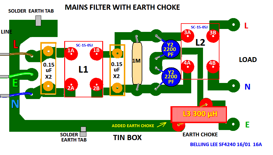

Hi just a quick rough layout drawing for my intended pcb. How does this layout look.
Not sure what you mean about 3/4 resistors do you mean in parallel ?.
Thanks.

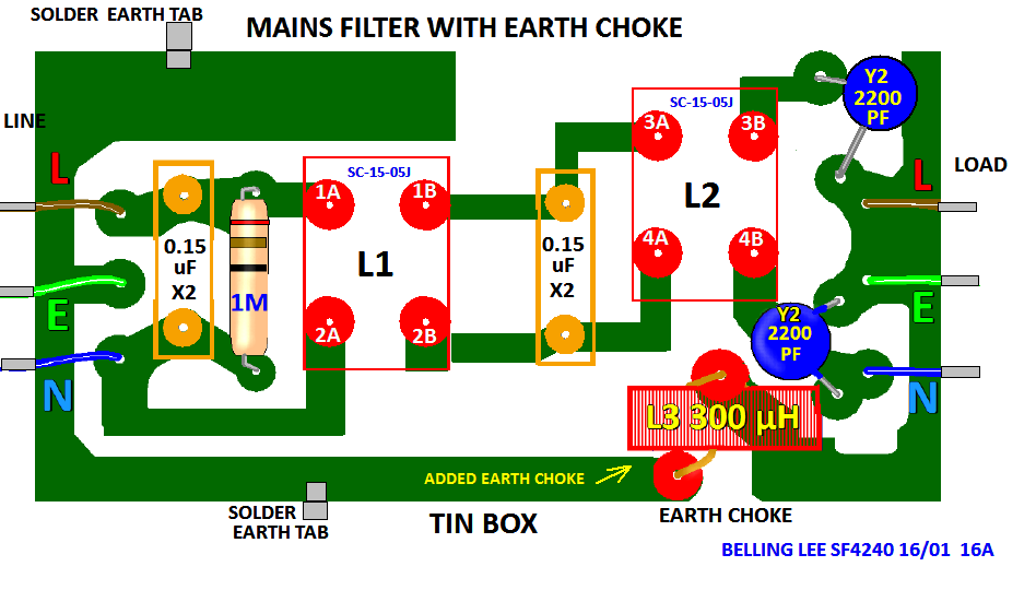

Forgot to add , all components on pcb will be placed into a tin case earthed by the tabs. And then completely
resin potted. Not sure though if the chokes being 500 uH instead of 450 uH will throw the HPF out of wack, regarding freq range suppression ?.
I suppose I could unwind maybe 1 turn on each though to get nearer 450 uH
Thanks.
This is not the same filter!
On the load side L and E are shorted together.
The Y caps have almost no function.
Not like this!

Do not worry about 1 turn. The values are not that important.
gee I must be tired. How the hell did I do that. I must remember not to build and test this pcb at gone midnight.
I have quickly corrected it now , will do a more tidy pcb tomorrow.
Thanks my friend for your time and help so far.
Regards.
:eek:
That would "choke" the earth line choke! :D .... .. .... ..
