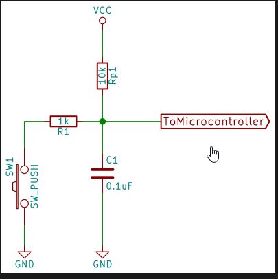

I have the sketch doing exactly what I want now. However, as I am 'triggering' the fade sequence with a PIR motion sensor, it will be sending approx 3v to
pin PO on the digispark whenever motion is sensed. But, what I am finding is that whenever I send 3.3v to PO it runs my delay loop instead of the fade sequence regardless of if I have it looking for a HIGH or LOW reading on that pin. When I take the 3.3v lead off of pin PO, it runs the fade sequence. So, I am wondering how I should be getting my PIR sensor signal to the microcontroller. I was able to figure out the code, but the electrical triggering part has me confused. Any help? :confused: Or, is it as simple as swapping my 'endless off loop' code with my fade sequence code? So just an electrical question...... Thanks
Apart from your code, how are you applying the 3v3 to P0 ? just tapping / plugging it with a 3v3 wire, then leaving it floating ?
Any such input should ideally be debounced or you can get a whole series of mixed up signals going to the micro.
A simple and usually effect switch input is like this circuit, its a press to go low, but you can reverse it to press to go high.
I think that is what I needed. The low voltage (3.3v) signal will come from the sensor's 'out' pin, of course, but it sends the signal for a minimum of approx 3 seconds when triggered, so it is not a true 'momentary' switch. Will your 000321.jpg schematic work in my case? If 000322.jpg will work, that is even better.....
I really appreciate your help with this! Yes, I was just tapping a 3.3v source into P0 for testing ...
You say that your sensor gives out a High pulse when active, so you need to use the circuit in 322.
Vcc is connected to your 3v3 , the other side to 0v/GND , so P0 is help firmly at 0v/Low until the switch is closed and P0 becomes High.
( leaving P0 unconnected gives all sorts of random signals, not recommended)
The pull down resistor can be any value to hand from 1k to 10k.

No, I was talking about your original problems and using the circuit in 322 for a manual switch as input to P0.
Actual connection to the motion sensor is something to do when you have sorted your coding problems out.
Also what you have described in your last post for connection to the motion sensor /p0 is not clear at all, always provide a circuit diagram as its too easy to misunderstand without.
It may not be necessary to use a transistor as a 3v3 input to P0 should be seen as a High.

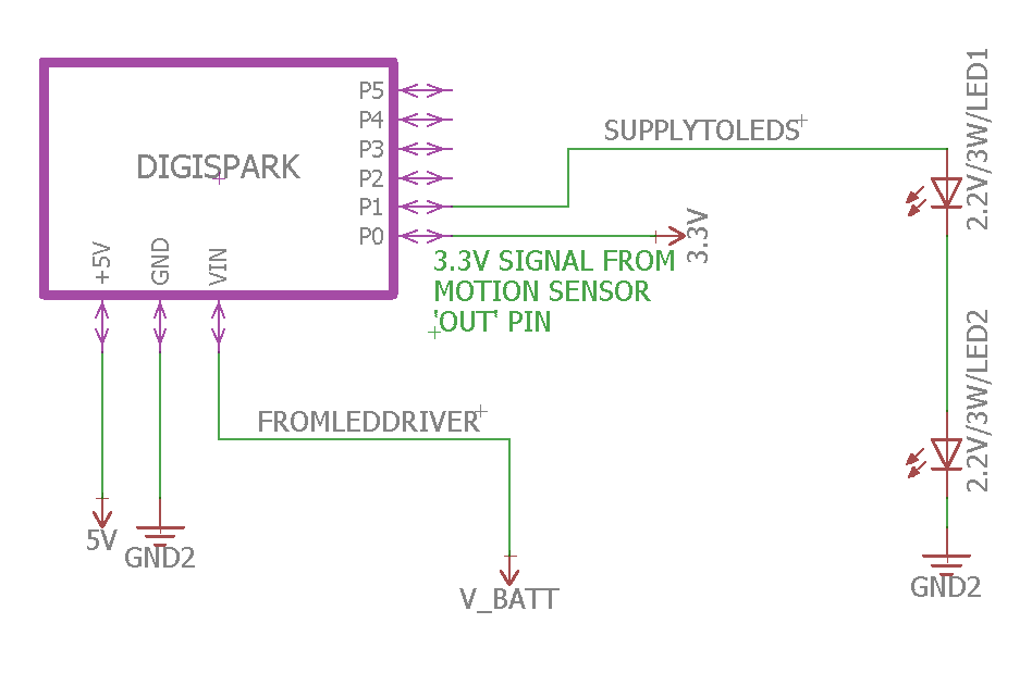

Wp100,
This is what I have....... please comment...
I was either going to bring voltage from the LED driver into Vin on the controller as shown, or let the voltage from P1 trigger a 2n3904 transistor to allow an isolated circuit supply the LEDs.
Thanks, you are really a big help!!

However on your diagram there are problems.
You cannot drive high powered leds directly from the chip / P1, it will simply burn out the chip.
You show Vin connected to the LED driver ? What are you using as the Led Driver ?
A led driver typically uses a control signal from the Micro/ Digispark, often a PWM signal, so it can drive the leds at various brightness.
For your input from the motion detector, the DP should accept 3v3 directly, my Arduino does, however you may want to protect both circuits by using a little opto coupler.
There are many similar devices , not just the one shown in the diagram.
You will probably have to lower the leds input resistor to that shown in the diagram, try 330R if you do not have a multimeter.
