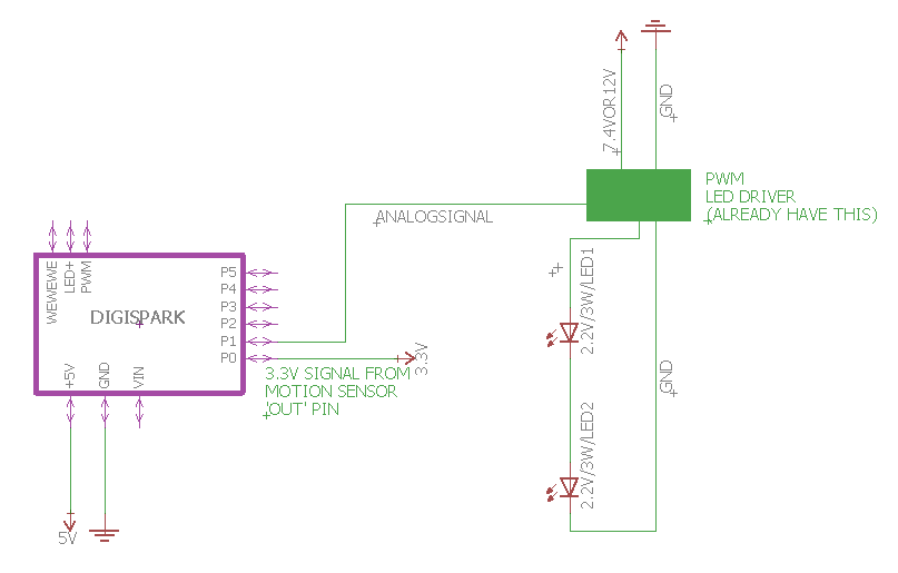

However on your diagram there are problems.
You cannot drive high powered leds directly from the chip / P1, it will simply burn out the chip.
You show Vin connected to the LED driver ? What are you using as the Led Driver ?
A led driver typically uses a control signal from the Micro/ Digispark, often a PWM signal, so it can drive the leds at various brightness.
For your input from the motion detector, the DP should accept 3v3 directly, my Arduino does, however you may want to protect both circuits by using a little opto coupler.
There are many similar devices , not just the one shown in the diagram.
You will probably have to lower the leds input resistor to that shown in the diagram, try 330R if you do not have a multimeter.
Great info! I did consider that putting the supply directly through the Vin would not be feasible, so I do plan to use a PWM capable led driver (I already have it) on a 12v battery circuit to feed the leds via an PNP transistor(?). I will update my schematic and post it soon. I like the idea of incorporating the serial.prints in my code to verify what is happening. I will look into that (tutorials).

As I'm editing my schematic in eagle, I just realized the the analog signal from P1 would only trigger a gate open or closed on the transistor, so I am going straight to a PWM led driver........... I'll post it soon.
Here it is:

Edit - the diagram looks ok

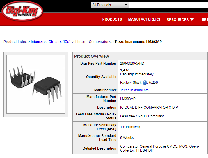

What are the numbers on U1? from the markings you can hopefully find the chip number and datasheet and go from there.
Measure the voltage from PWM control to Power In -. Suspect it will be +5.
Wp100, I finally lookedcat the sketch in post #20. That opto isolator is pretty slick.... my fade sequence seems to be working fine right now as I have a 2N3904 NPN transistor on the neg leg of the leds. It's being switched by the PWM signal from the digispark. I'm now able to run 12v to the leds and control them with low voltage from the controller. I'll let you know if something blows up........:eek:
